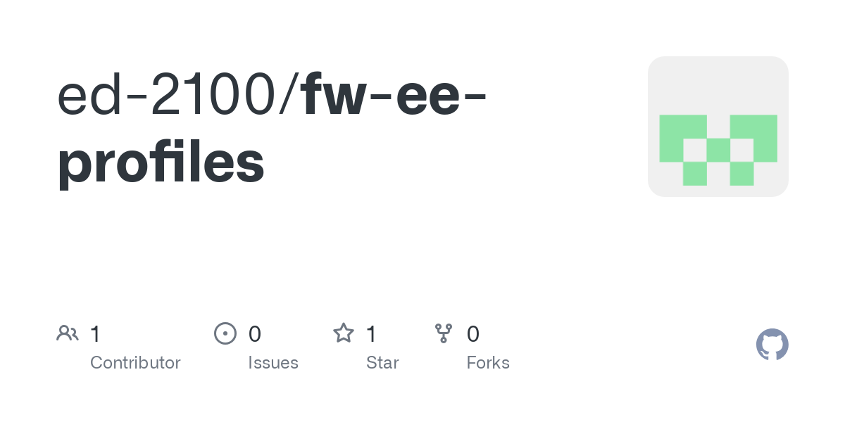

Here’s a Github repository I’ve put together to hold my public easyeffects profiles. The one this post references is v1.0.0.
