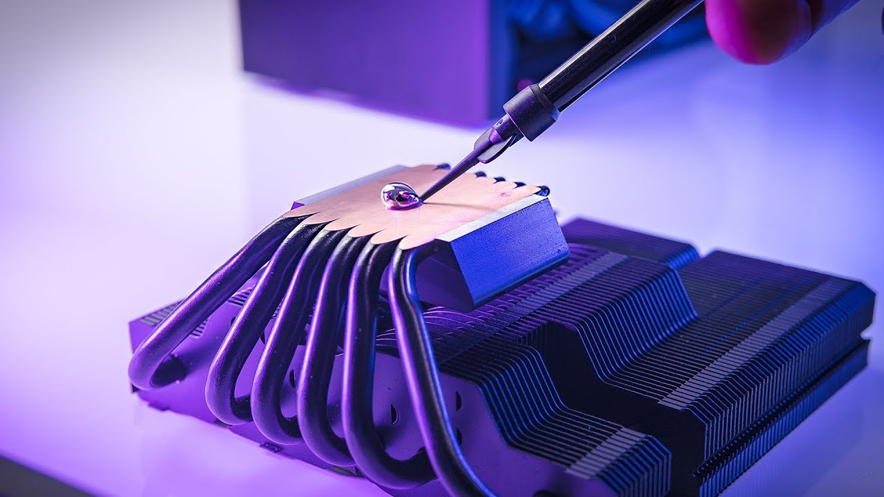

I was about to buy some thermal paste to reapply when I clean ou the cooler but wondered if liquid metal thermal paste could improve the thermals, as it did in Linus Tech Tip’s video on the subject on a gaming laptop.
Has anyone tried to do this before? If so, what are some aspects I should be wary about?

Be very careful with liquid metal thermal paste!
It does work as you would expect, but it’s risky and not much better than a good non-conductive thermal paste.

I havent used liquid metal on my framework, but I did on my old sandy bridge laptop. The temperature difference between liquid metals and freshly applied arctic mx4 was about 15°C with the fans spinning slower, iirc. It was a huge upgrade. I havent done it on the framework yet, since mine is very quietly and i have it in the low power setting. If you apply liquid metal carefully, there is nothing wrong with it. You have to cover all metal contacts close to the CPU with some kind of conformal coting (I used nail polish, but its not really made for this application). If you dont use too much of it, it should be fine.
If you dont want to take the risk, which is understandable, I would recommend something like thermal grizzly kryonaut as a thermal paste.

Frying your motherboard comes to mind…if anyone stumbles across this thread and still wants to do it, make sure to buy conformal coating to spray around the chips you are putting liquid metal on. Make sure to apply it properly as well, putting liquid metal on both the heatsink and the CPU, it doesn’t take much.

Don’t most youtubers find that liquid metal is only marginally better than a good thermal paste anyway (like +/- 1 degree) - I’m not sure that would move the needle on reducing the fan spinup. I’d love a solution though.
@gmv it depends on the usage, it is of great value when placed directly on the die as in this case as it speeds up transfer between the die and the IHS. If it is just used on top of the IHS, then it’s usefulness is diminished somewhat. Since this is a direct die-to-heatsink contact, it is worth doing but carries risk as stated earlier.
Theoretically, the fans would still spin up but at a lower speed and reduced volume as the transfer efficiency is increased
This video showed a 3 degree difference between liquid metal and thermal paste albeit on a desktop part
The die is one side of the contact. On the other side, ideally, it should be direct heatpipe contact. The Framework laptop’s heasink&fan module doesn’t expose that unfortunately. Instead, there’s a copper plate, then solder, then heatpipes, then press fitted fins. There’s a degree of inefficiency in this chain.
