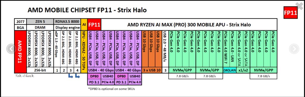

@Djip I’m not sure that I follow correctly the details on that (very interesting) presentation. It it saying that USB4 stack operates in 3 modes, essentially:
  1. Generic USB4 (& 3) traffic: even with USB4 hosts & devices, the connection gets tunnelled via internal USB3 devices. And then these internal USB3 devices actually only have to support Gen2 x1 lanes (x2 optional)?
  2. DP: handled specially because no-one would accept the limits of #1 for display output.
  3. PCIe tunneling: handled specially because no-one would accept the limits of #2 for storage or GPUs.
Is this right? If so it seems entirely crazy. AIUI the Gen2 x1 lane speeds would be around 10Gbs, while Gen2 x2 lane speeds would be around 20Gbps. Since we are seeing 11Gbps-ish speeds on thunderbolt-net and apparently similar on Windows, does this mean that the software stacks are just doing a Gen2 x1 lane internally?
I am probably (hopefully?) confused here and would appreciate being ELI5ed.
No. Not modes.
USB4, as TB3 before it is essentially just a container. All it ever contains (other than low bandwidth configuration and management packets) are tunnels.
And you listed a few of those tunnel types with DP, USB3 and PCIe.
Cross-Domain, which is what is used for USB4Net packets would be a 4th tunnel type.
Also, USB4 only mandates USB3 10G support in all forms. But allows USB3 20G support and new USB3 Gen T (another tunnel type), which can have near arbitrary bandwidth (as its restricted to only being virtual on top of the USB4 network).
(For reference, TB3 did not have USB3 tunnels, it started out with DP and PCie only and Cross-Domain of course. USB4 added native USB3 tunneling and native USB2 support to make it more compatible with the existing USB ecosystem, which TB3 was not).
Intel has started supporting USB3 20G tunnels a few gens ago and in their new Barlow Ridge controllers (TB5 hubs), but AMD is still sticking to 10G native & tunneled so far.
USB3 on top of USB4 also follows a normal USB3 topology. So you will only have whatever USB3 connection from host to a USB4 hub (mostly 10G, like you said). And all 4 downstream USB3 ports that the commonly used Intel USB4 40G controller supports are driven by an integrated USB3 10G hub. The newest Intel controllers do 20G here as well. But that is essentially the USB4 architecture. For more USB3 bandwidth, you would need to use USB3 Gen T tunneling. Which is specced since USB4v2, but even Intel did not mention it anywhere with TB5. So so far, that is not coming. But all of this is only relevant for downstream USB3 functions. USB2 functions use sth. else and PCIe or DP use their respective tunnels.
A common limitation is that, USB4 hosts do not need to support dual-lane operation for cross-domain connections (between 2 hosts). So they often only make 1x20G lane connection (instead of the 2x20G lanes that would make up a USB 40G connection). That is what matches the ~18Gs max seen in the past. There have been some reports of people getting dual lane connections with Intel-integrated USB4 controllers under linux.
Did not look like AMD would support those dual lane cross-domain connections to me, but I have only tried that with Windows+Linux and Windows+Windows so far (and on top of the controller never entering bonded/dual-lane mode, this could also be explicitly disabled by the USB4 driver. And only for Linux do I have the diagnostic tools to confirm, that Linux does not restrict this).
Any further limit would need to be down to networking limits (which with USB4net is basically all software emulated) or it would need to be a particular bandwidth limit in the cross-domain tunneling infrastructure of Strix Halo. Because I believe I have seen Strix Point go beyond that in USB4Net (but not sure, as I mostly have one side still on Windows, I get Windows’ firewall overheads. But also, Windows configures larger packet sizes than Linux, so the Linux USB4Net implementation may still have room to improve there as well and in this combo the direction from larger packet size to smaller is usually way less performant).
