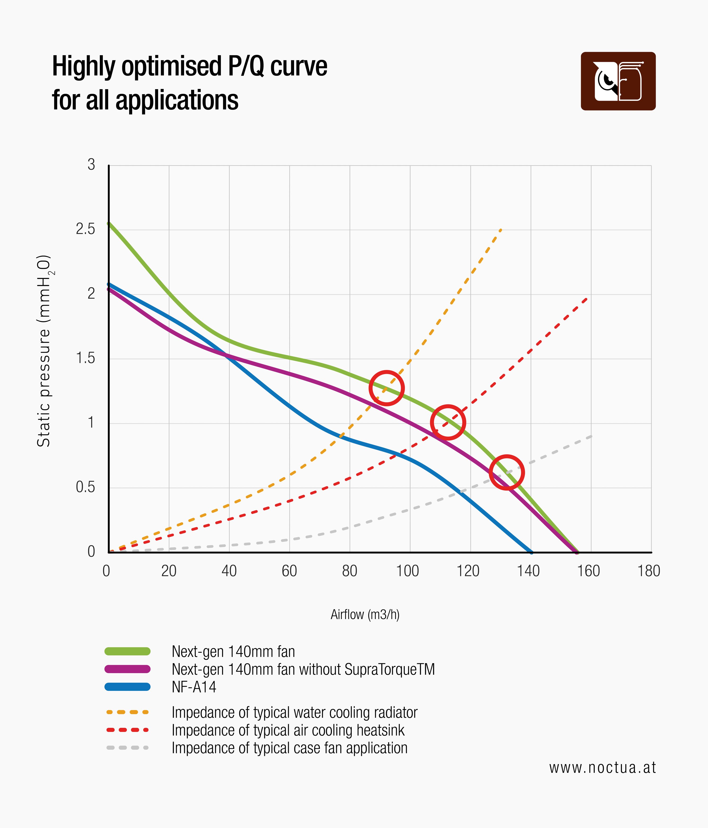

Interesting charts. I don’t think a static pressure rating for Framework’s NF-A12x25 PWM has been published, but because it’s a slightly higher rpm NF-A12x25 PWM G1, assuming the static pressure world be closer to the blue line on the first chart, than to the G2 green line, and the next Gen 140mm fan would be the NF-A14x25/r G2 PWM?

I put the charts through Gemini a couple of times to get a better understanding of what they were showing and the bottom line seems to be that in a CPU cooler environment, the significantly higher airflow of the 140mm g2 is going to outperform the higher static pressure of the 120mm g2, although in radiator environment, this world be reversed.

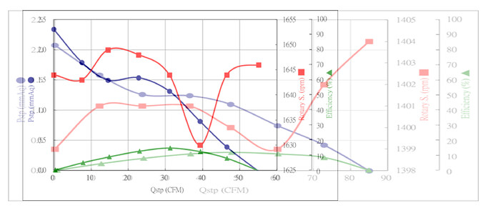

Cybenetics tested all 3 of them including the HS version. They provided PQ charts.
Those are great. I didn’t dig in to the site yet to answer this for myself. But I’ll ask you, do you happen to know which kind of radiator fins they push the fan into for their tests?
@s_m8o See my post above about the Cybenetics benchmark results

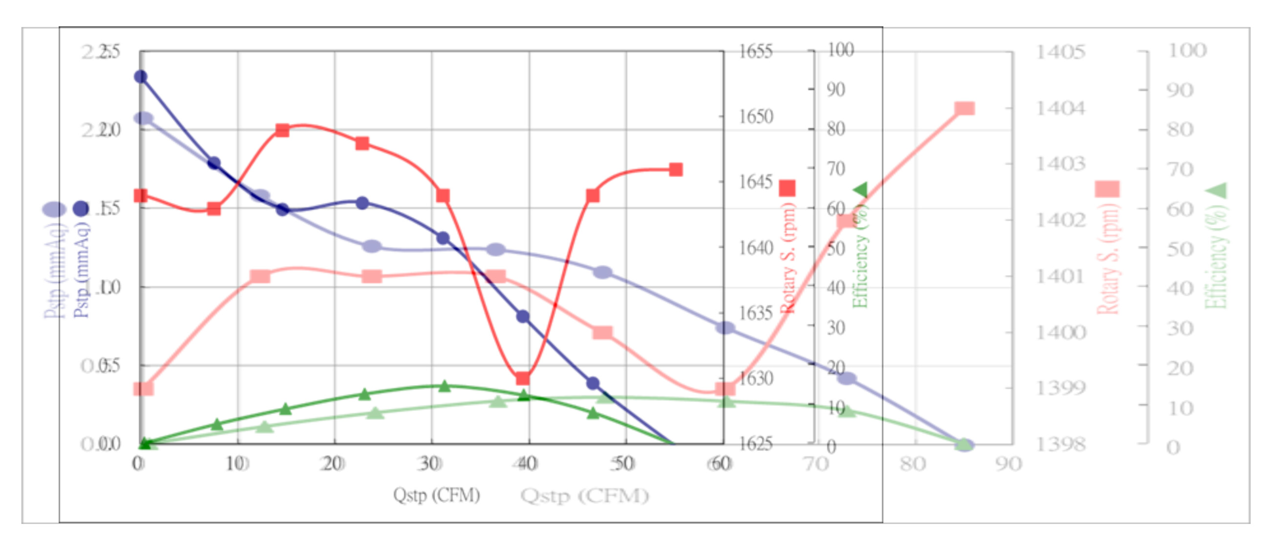

I put the A12 G2 100% speed and A12 HS 90% speed PQ charts together - because at this setup they have similar/comparable PQ curves.
A12 G2 runs at lower speed so the noise should be better than A12 HS.
My theory is that G2 will perform better (in terms of noise) but HS can push more at 100% speed.
Edit: adding A12 G2 100% speed vs A14r G2 100% speed - the slope of the curve is different
Next is to get the CPU radiator fin’s PQ curve. But it’s probably difficult to get.
