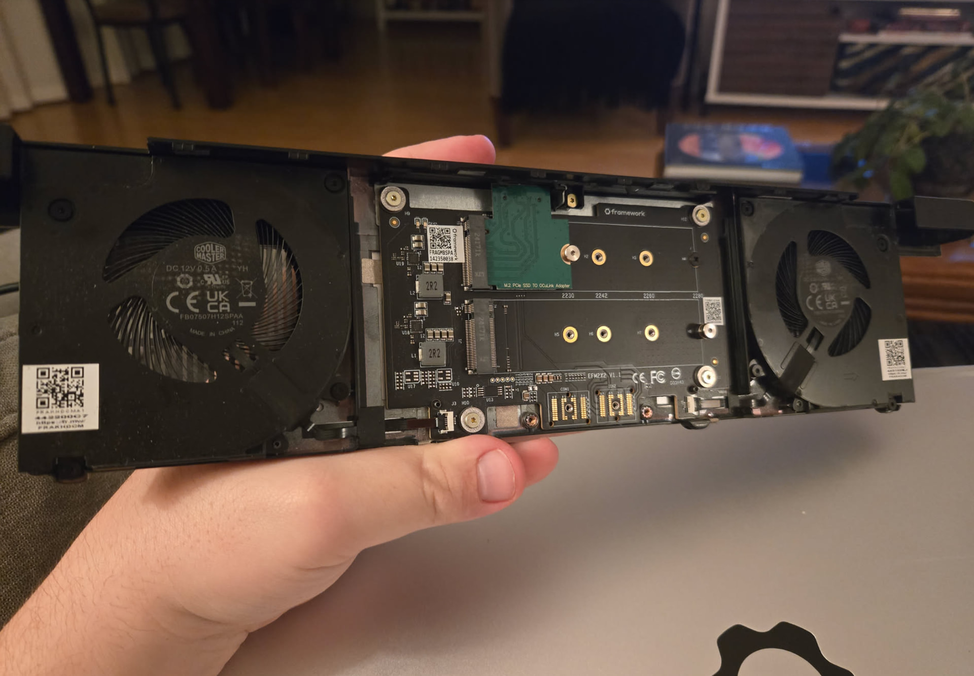

I can now confirm the adapter is working with the Minisforum DEG2. Works just like the DEG1 but with extra thunderbolt connectivity.

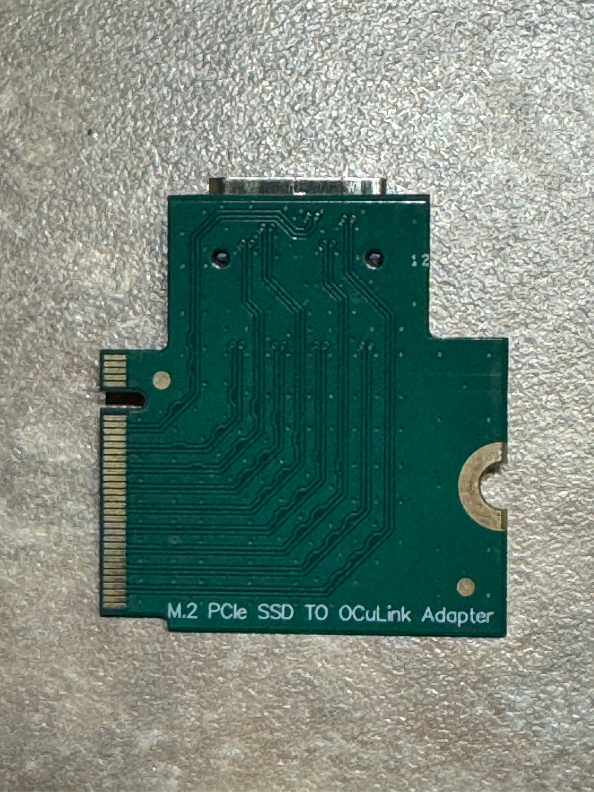

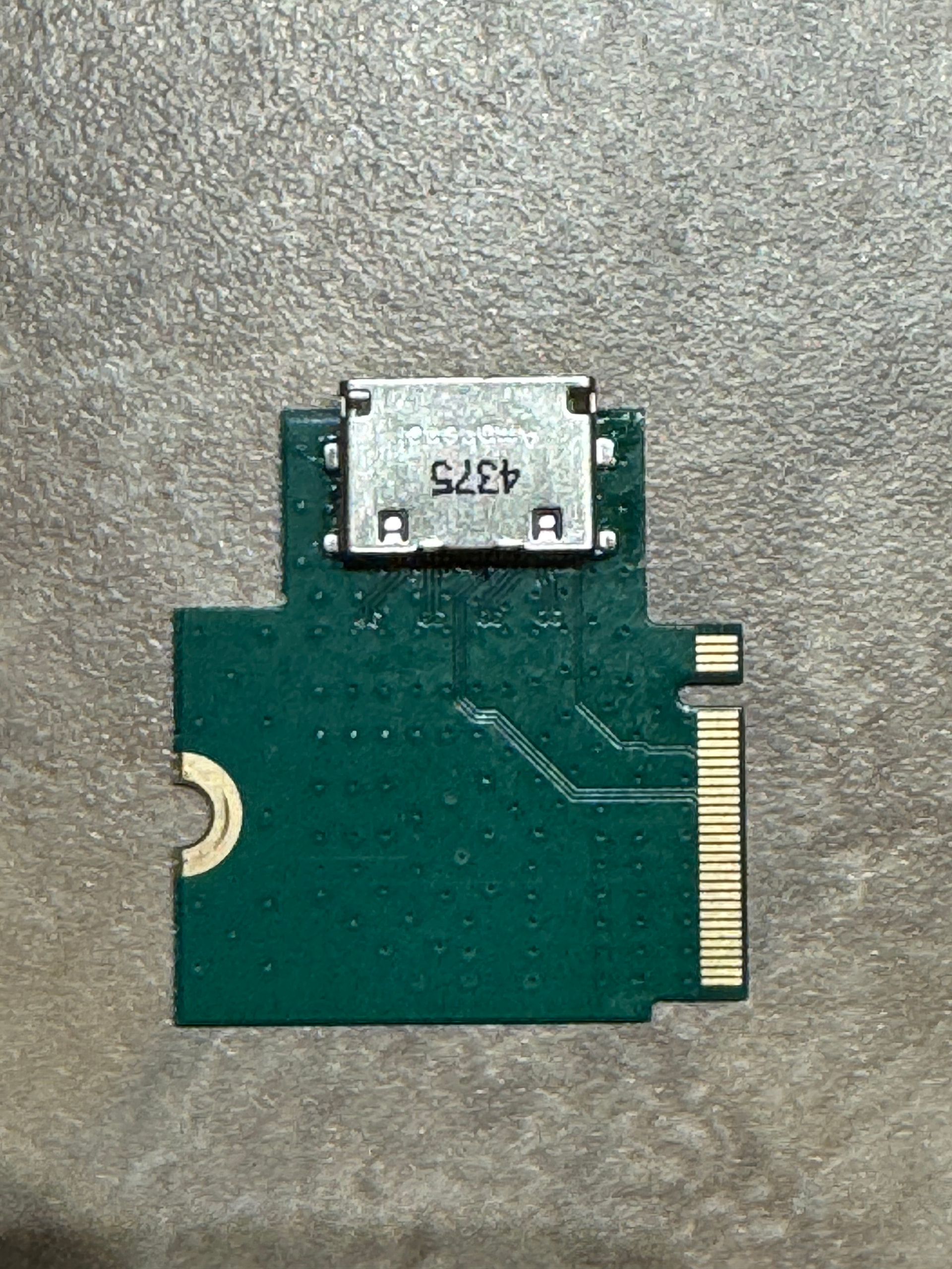

When I first started down the path of getting these adapters, I rolled the dice on the first revision and ordered 10 pieces. They did not work in the Framework 16. I spent a lot of time testing multiple pieces, in multiple docks, with multiple cables. I even sent one to @OVER_CL0CK who confirmed that it doesn’t work.
I am glad I held onto them because I was able to take a couple of pictures.
The manufacturer ended up creating another revision and sending a single test piece to me. That one worked, and I rolled the dice yet again on a larger order. Thankfully, those ones also work and are the revision that I sell. The traces on the adapter I sell are noticeably different than what you see in those photos.
I don’t fault anyone for wanting to find a better deal, but if you are ordering an adapter that has traces that look like the ones in the photos above, you are probably going to be disappointed.

I didn’t see the link, so I’m not sure what you’re referring to. Did I understand correctly that someone copied your first, broken design and is selling that? I’m not sure why else someone would be disappointed.
That is correct. I didn’t put the link in but someone has copied the original design (exact copy down to the text printed on the adapter, so it must be via the same manufacturer). Perhaps they created more than the 10 I originally received and have sold them off to someone else. Not sure.

Got the adapter and it’s so much better than the nvme to ribbon cable oculink setup that I was using before! Took me a while to even slide the expansion shell out because the ribbon cable wasn’t secured well enough and was catching on the body. Super easy to get in there and the included 3d printed bracket cover is nice and went in easily. Haven’t tested it yet with my Deg-1 + 3060 ti setup, but should have a chance soon.
