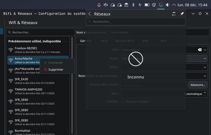

The second issue: wifi instability
Here are the symptoms:
My wifi card is a MediaTek MT7925.
Here’s the output of a couple of commands that will hopefully give more context:

  • lspci | grep -i wireless doesn’t return anything.
That’s it!
Do any of you have experienced similar issues?
Is there any known fix that I could apply?
Once again, any help would be much appreciated. Thank you!
