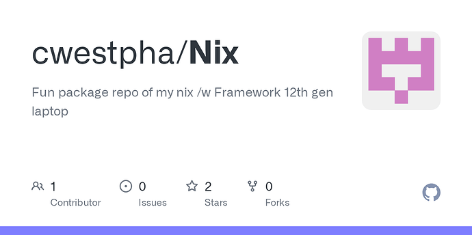

Anyone got fw-fanctrl running? Tried to create a nixpkgs, but i’m still a to big beginner atm
I found the following which seems to work fine:
Thanks alot, don’t know, why i wasn;t finding it on github. Was mostly look for the ectool GitHub - ssddq/fw-ectool
Hiya, author of this repo here. Just stumbled upon this thread, cool to see that some people seem to find the packaging of fw-fanctrl helpful ![]()
If you encounter any problems I’d appreciate it if you could open an issue on Github. I’m not very experienced with packaging software for Nix, so any feedback or tips would be great!
