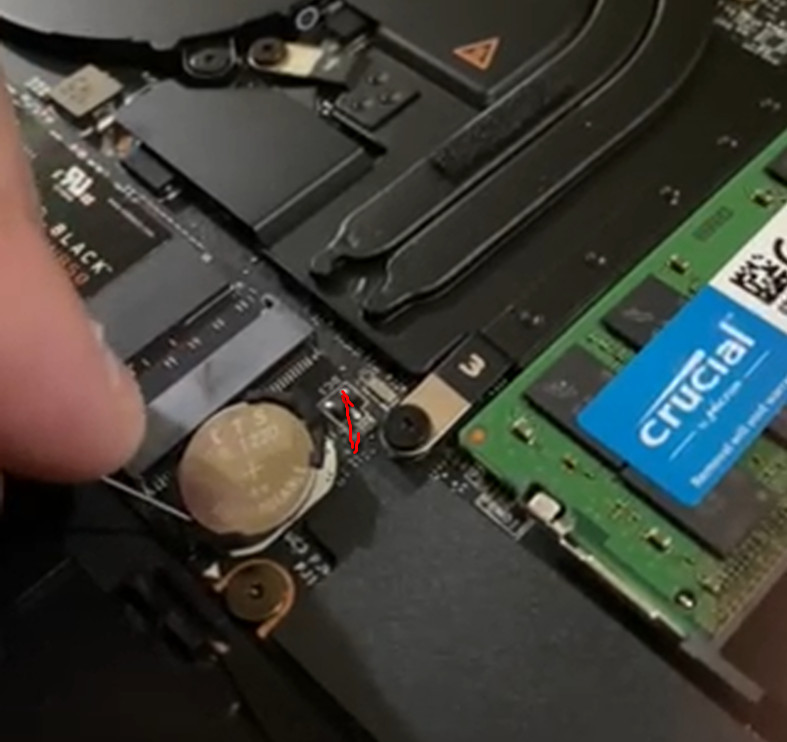

Hi David, when you say the cell holder, are you referring to the battery slot that is attached to the motherboard? Take a look at this thread, I had a similar issue and it was due to the battery holder not properly soldered into the board. I got a replacement board.
Hi Kimo, my botton battery holder lifted up as you push down on the pin. It had no resistance it just rocked on the edge it was levered from. Personally i dont think that is my problem as when i did a reset, there was no battery and no mains attached and when i put in the button cell i immediately got the flashin red lights, i then carefully tried to carefully wiggle the button cell but the red lights stayed flashing. if i was to guess i would say my issue was more than likely it came unglued rather than unsoldered as i would have expected no power from the board.

For anyone who’s following my problem is solved but not fixed (asofyet). It turned out to be the button battery holder. I know i said it appeared to work before but i must have pressed it into connection when putting the battery back in.
Anyway, i booted with the case open and held the battery down and all works fine. It did one boot with memory check (green lights) and when i rebooted (all from internal battery only) it restarted without memory check (well faster anyway ). i then placed a small rubber grommit on top of battery so the case holds battery down and all is working.
Clearly i can’t operate it like this as i could be putting the board under stress. However, this one problem has been solved. Support will be informed and hopefully there will be a more permanent fix. I’ll try and attach a video to this message (not sure if i can or if it will work) if there is no video attached then i failed.
Dave
Attached is a still i couldn’t get a video format that worked

I had to do this:
  1. Remove the CMOS battery.
  2. Unplug the laptop battery and wait for 60 seconds.
  3. Reinstall the CMOS battery.
  4. Plug the laptop battery back in.
  5. Attach AC power and let it charge overnight.
This sort of resets everything and gives the rechargeable CMOS battery time to get back up to 3+ volts. The whole problem here was that if the CMOS battery voltage drops low enough, it won’t recharge, regardless of the laptop’s battery level and/or AC adapter being plugged in. Why they don’t just use a standard CR2032 CMOS battery, I don’t know…
I absolutely agree, I’ve had to go through this rediculous ritual several times now, because the RTC battery has discharged. At some point something is bound to break. This RTC battery issue is definitely a design flaw. New updated boards should be given to those of us that find this a real problem. After all, why should we pay for a new motherboard, just to get a system that works the way it should? An official reply should also be forthcoming. For instance, is it possible to completely fix this issue on current mainboards or is it not possible to fix? Also, is it guaranteed fixed on 12th gen boards?
No, the RTC battery clip is perfectly fine, you just have to use the right technique. Some boards had too little solder but that is a completely different story.
