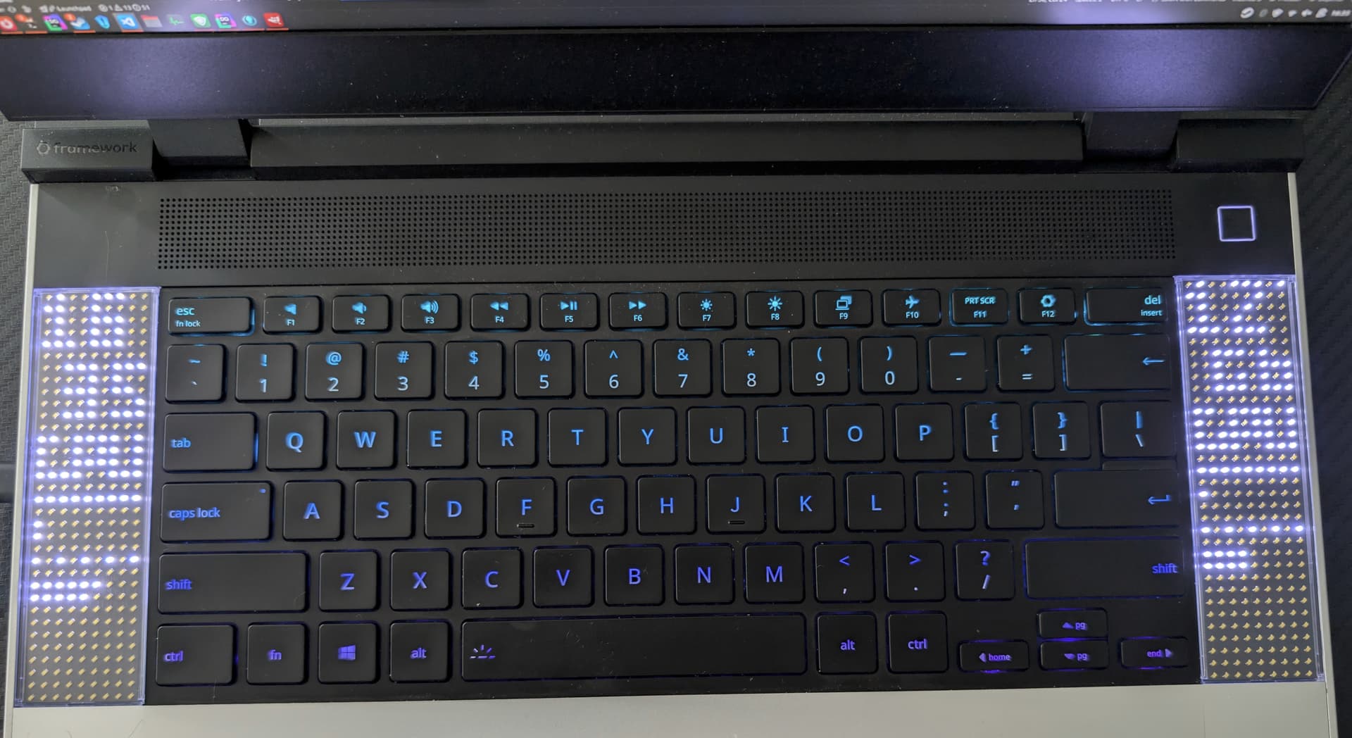

Just recently got my LED Matrices and got them installed. I wanted to display a fair amount of information on my matrix. I started with a static program that was drawing information, and then I wanted something that was a bit more flexible and configurable. I’ve been writing this tool (very much to be considered an alpha product) to do exactly that.

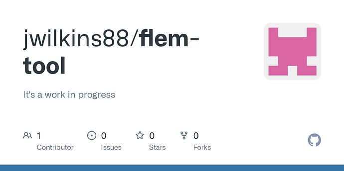

As it says on the readme, it’s a configuration based, async renderer that works with independent modules. I’m not finished creating all the modules that I want, but it’s in a place where it’s working “well enough” that I feel like I can share.
The configuration reloads automatically (i.e., if you change your config, the matrix updates with the new config), and each module can have its own refresh rate (i.e., if you want your CPU module to refresh every .5 seconds, that doesn’t make the clock refresh every half second)

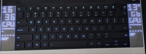

A gif of the updates:
Updates:
  1. Officially moved the version to 0.1.0 - Considering this a beta, as it’s not that well tested or optimized (yet)
  2. Weather Module - See the details! This one is a bit unique, and it’s using the other module that I finished up for this update as a submodule. The…
  3. Animator Module - See the details! I can’t believe I didn’t start with this. It’s a really simple concept, but it’s super powerful. It allows arbitrary scenes to be drawn and animated by providing an array (see the weather animations for examples). It can be used with an external file that holds the animation data or the animation can be put directly into the config. It can draw everything from complex, full-panel animations to simple, static 3x3 drawings. Each frame specifies its own duration, so you can easily make whatever you can imagine. Still works with scenes, so you can rotate your animations.
  4. I fixed a nasty threading bug that had been lurking for a while. After fixing that, everything is working much, much better than it was previously. I imagine that it would have resulted in some really poor performance and memory leaks if I hadn’t caught it when I did.

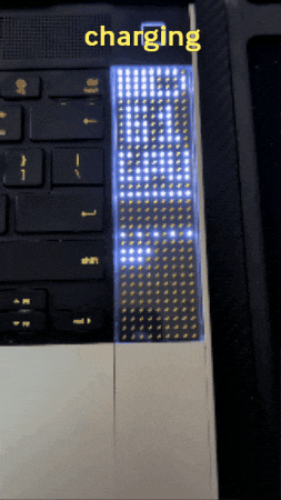

Just released v0.2.0. I added the battery module and fixed a bug with the pips on the bar graphs. They were always showing one more pip than they should have been.
The battery module has three different states:
Critical - A configurable lower threshold to blink the battery pips to indicate a low battery state
Charging - Shows the current charge pips as well as an animation of the battery filling. Once the battery is filled, the animation stops for 2 seconds and shows the current charge
Discharging - The last battery pip (indicating current charge) blinks to show that the battery is discharging
You can also specify whether or not you want to show the numeric percentage below the battery or not. If you don’t show the percentage, this is a nice, compact little module - 4x9. Super easy to fit into almost any scene

Battery Module in action:
