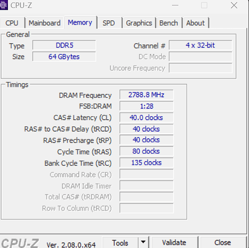

All,
I got my Ryzen 7840U DIY unit last week and had my other components lying around for a bit:
  • WD SN850X 2TB
  • 2x32GB Kingston Fury Impact (KF556S40IBK2-64) → SK Hynix dies
  • Windows 11 Pro
I can confirm that the RAM runs at 5600MT/s and CL40! This kit seems to be one of the fastest available. Highly recommended, especially this capacity. That should keep the laptop running for quite a bit.
Happy building!

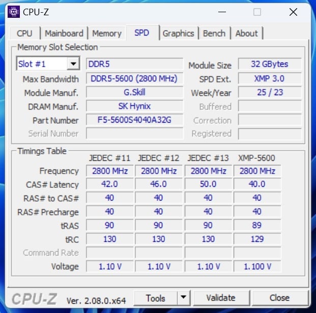

Thank you very much for the upload. After reviewing the information on the two CL40 kits available, the following screenshots from the reddit thread caused some confusion for me:
Does that mean, the G.Skill kit only runs at CL40 with XMP enabled and with JEDEC only at CL42 at best? Even though this info apparently comes from a Framework Laptop 13 user…
In order to clarify this, I’d be very much obliged :pray:, if you or somebody else would kindly upload the corresponding SPD screenshot for the Kingston Kit.

That kit has equivalent specs to Framework’s official ram.
G.Skill also produces another kit (model number F5-5600S4040A32GX2-RS for the 2x 32 GB variant), which is the only kit with as good specs as the Kingston kit afaik.
