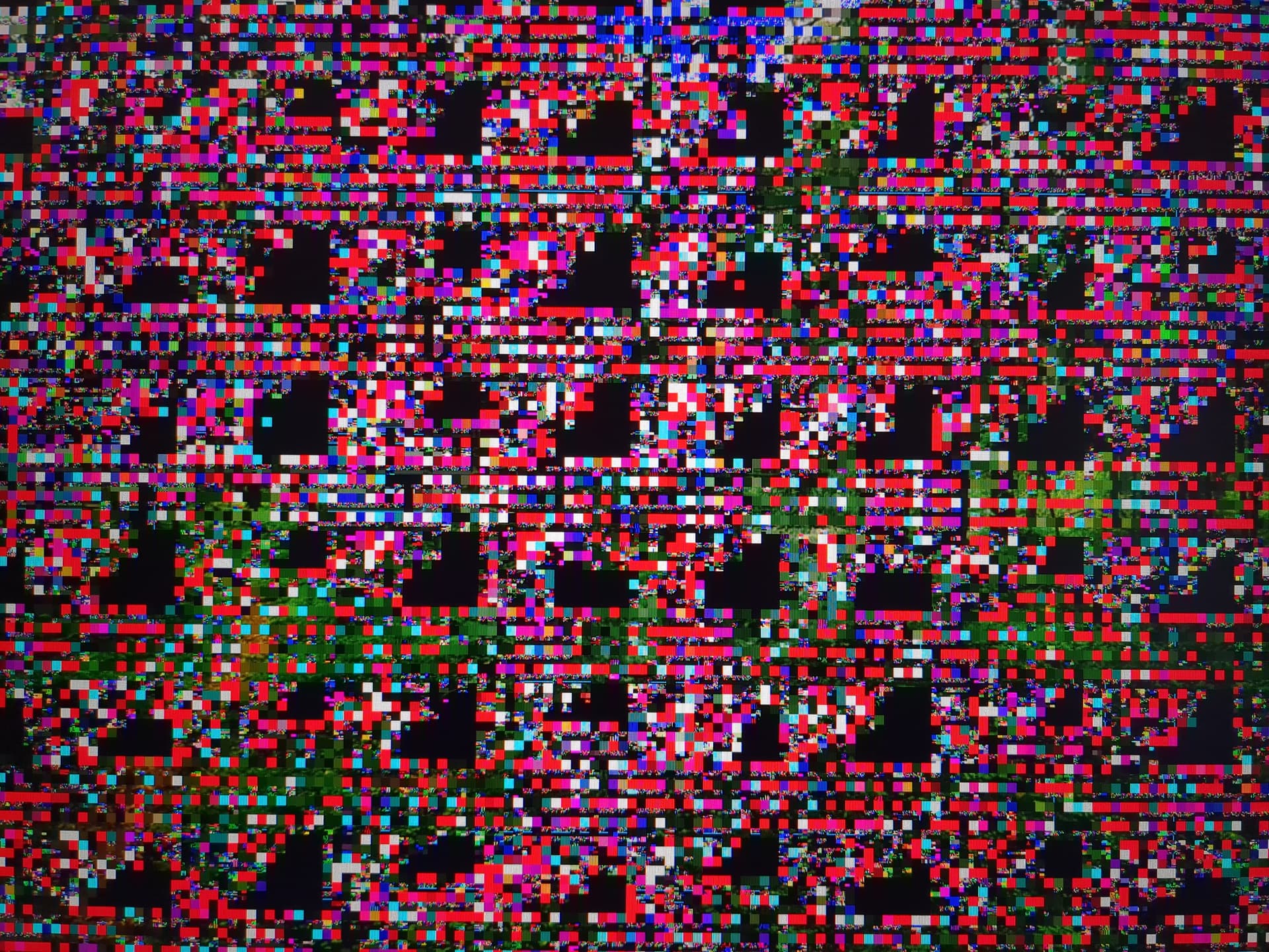

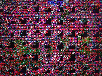

I am experiencing some glitches on latest kernel with Plasma/KDE: this only appears on 6.7. Anyone has seen something similar, not sure where to check for a bug report/issue
What are “some glitches”?
sorry, I mean graphical glitches, the screen becomes segmented into pixelized blocks, like a chess mat, very distorted view. it happened at least 3 times, but it seems I am now unable to reproduce :thinking:
EDIT: I was able to reproduce, and as I remembered, nothing show on the journal/system logs
here is a picture
I’m having a similar problem with gnome but white screen or hyper flashing on the newest kernel I just removed that line and went back to the stable kernel.
amdgpu.sg_display=0 didn’t help me but some people report that it fixes the issue.
