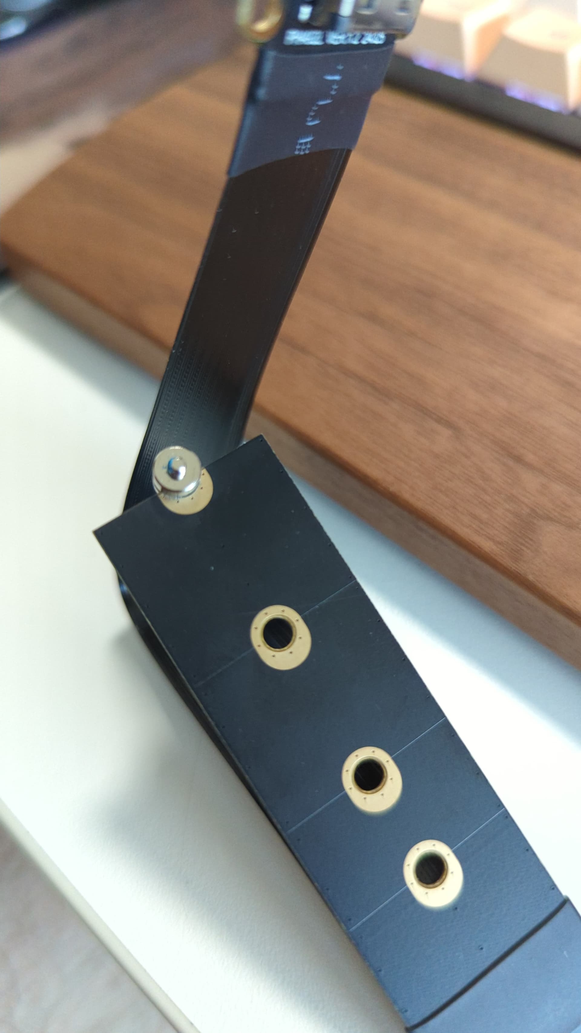

So did anybody hab problems with the Framework screws with the space?
The board seemes too thick
Yep, I’ve described this in this thread’s first post :slight_smile:
