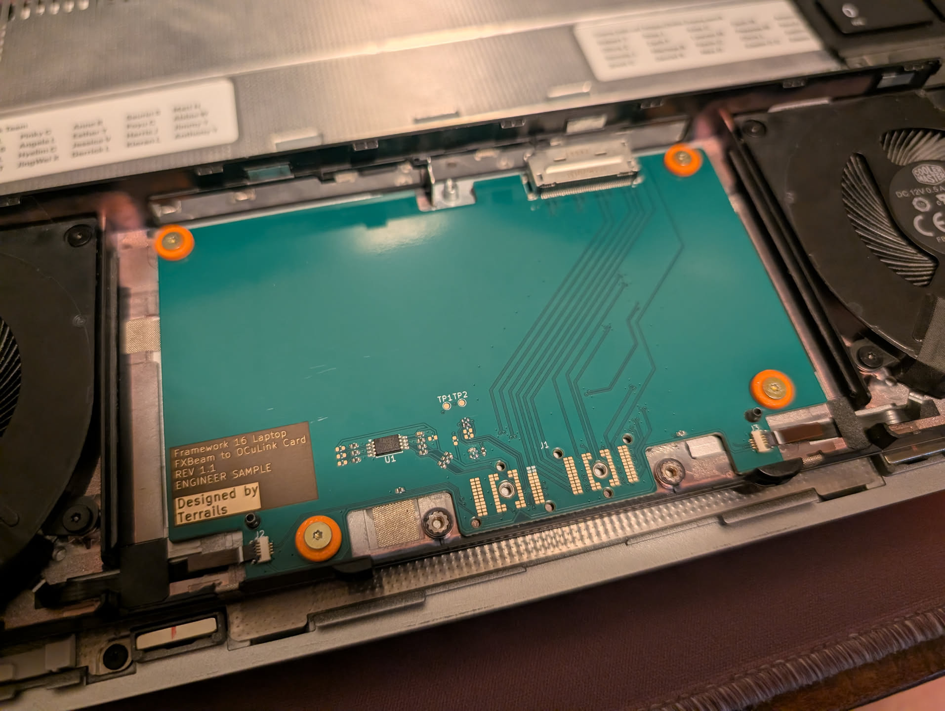

Here is a photo of the board
It is exactly the current version available on my repo, but I have just moved the 0 Ohm resistor that connects to the PCIe reset signal on the OCuLink connector. I originally had it connected to SA5 which is marked as “PEX_RST#” on Expansion Bay github, but now it is connected to PF3, which is the “EXT_SSD1_RST#” signal. I do wonder why it doesn’t want to work using the PEX_RST and what even is the use of that signal then.
