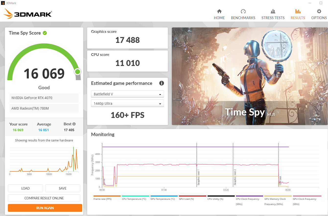

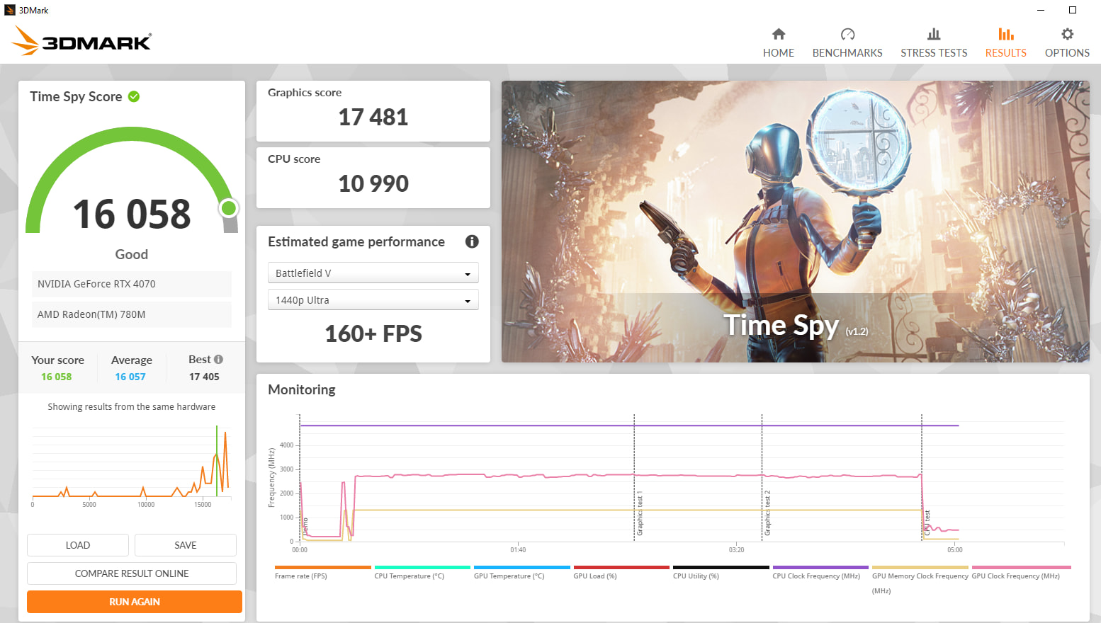

@FWPL So i finally had time to run some 3dmark tests for the 100cm and 50cm cable. Seems like no difference. Bottom half are 50cm, Top half are 100cm.

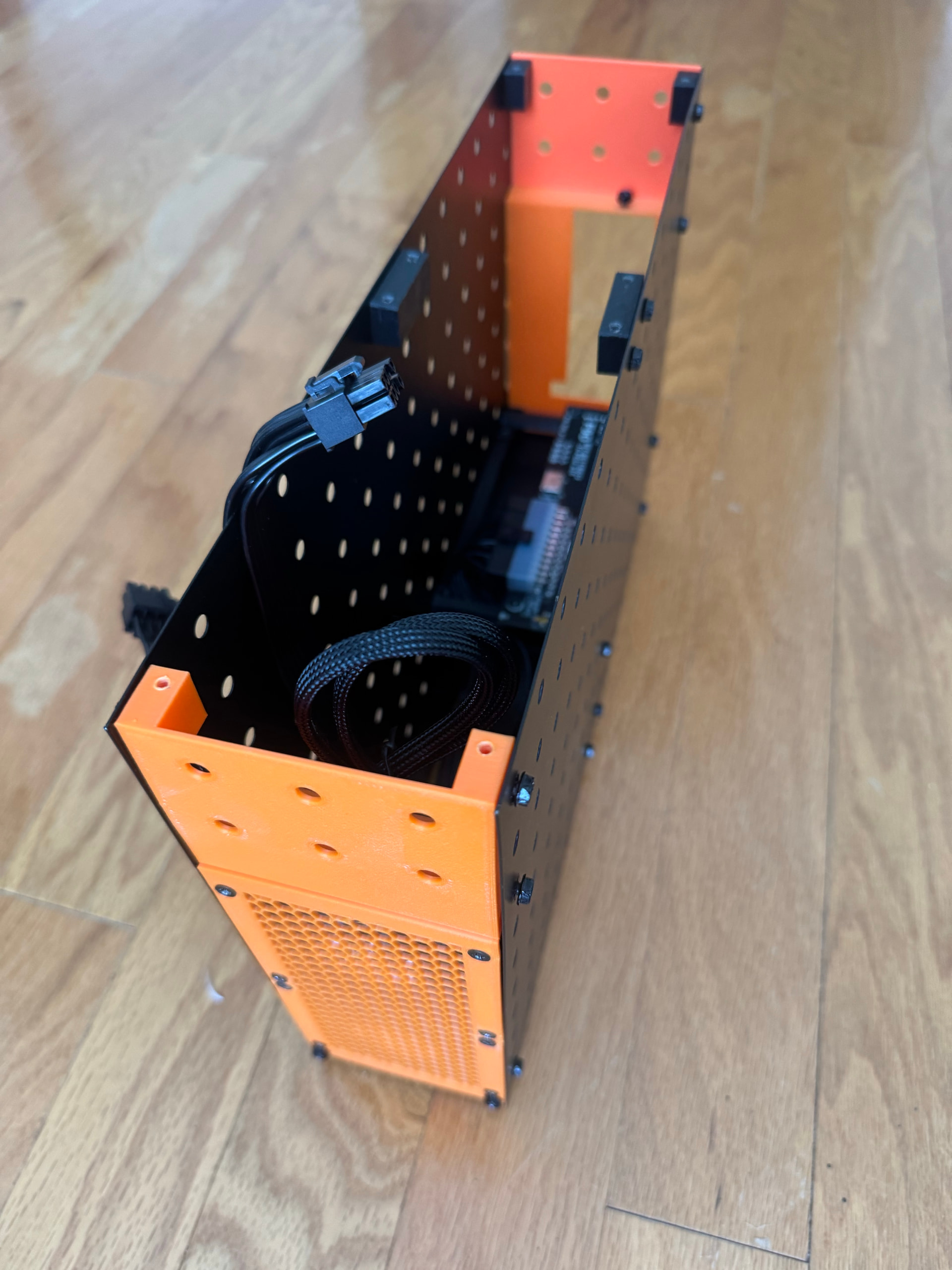

Hey everyone! I’ll be retrieving Filip’s board this weekend and am pretty excited!
However, it looks like my custom eGPU is not going to work out. I was experiencing sudden shutdowns with my Apevia 500W FlexATX PSU. I suspected the maximum +12V @ 396W was unable to handle the RX 9070 XT spikes, so I acquired a 600W unit that does 576W on +12V. Sadly, still experiencing the sudden shutdowns. I will have to try a whole new (larger) custom design with a proper ATX power supply.
I still plan on reusing the black metal pegboard sides though. On the bright side, the final design should easily accommodate a 3-slot (or more) card.
