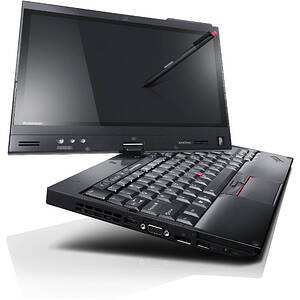

We can make the screen rotate like the old Thinkpad X220, Dell Latitude XT2 and Hp Elitebook.
Those are absolutely insane. You do have to live with a massive chin and potentially a “knee” behind the bottom half of the hinge, but you can have as thicc a chassis you desire.
Yes, the hinge isn’t the most strongest and they do wear out somewhat quicker than a traditional hinge, but the cost is absolute miniscule if you can replace it yourself and is something I am willing to pay to own one, if one ever existed.
GPD P3 also have such a hinge and is one of the killer-features for me to consider.
