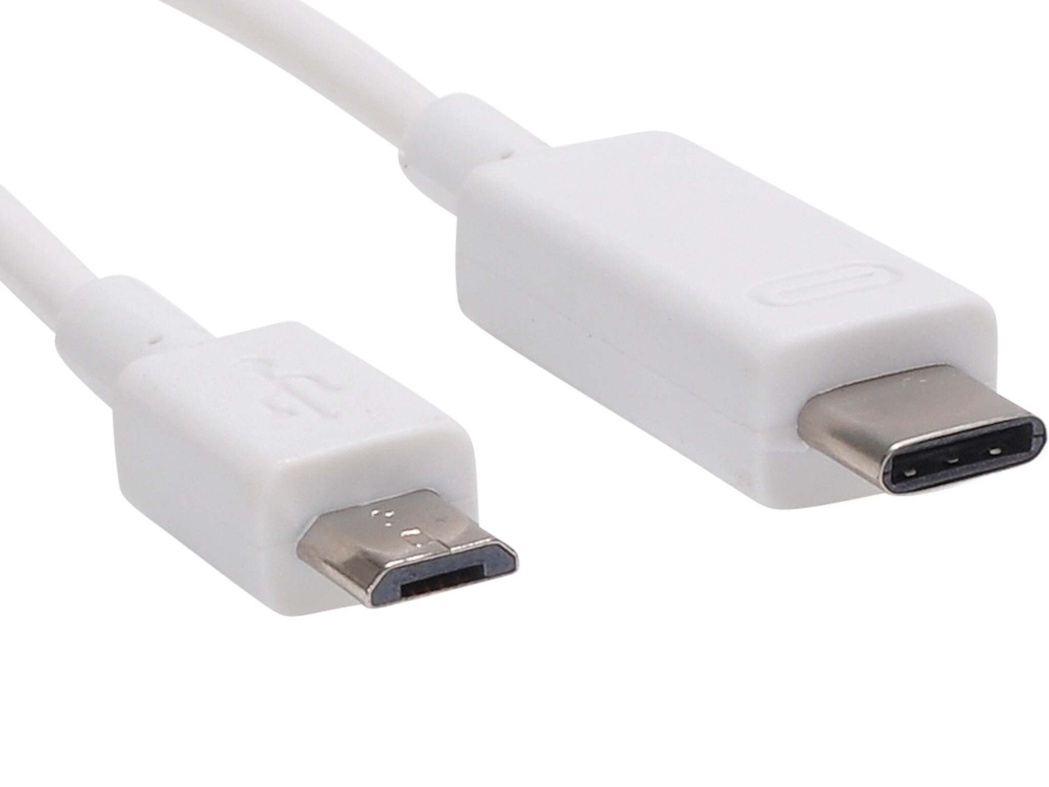

Pet peeve, don’t call USB-C Micro USB
Micro on the left, C on the right.
