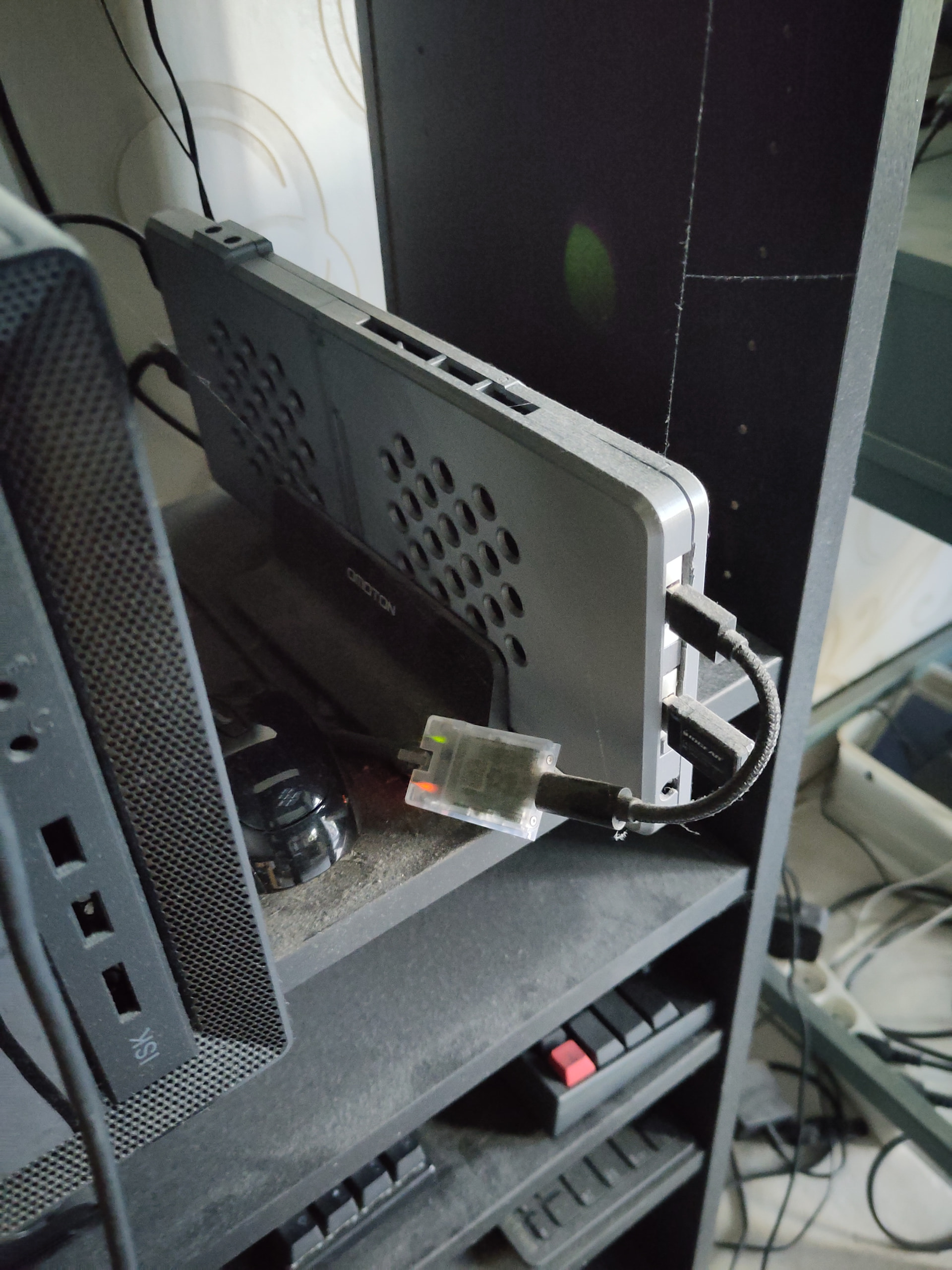

I have been using an 11th Gen Mainboard as a home server as well. It has been running all of my self-hosted services in VMs as well. Has worked really well, and is going on 4 and years at this point.
Excuse the dust, but it evidences the length of time it has been running (Hahahahahaha):
More info here
