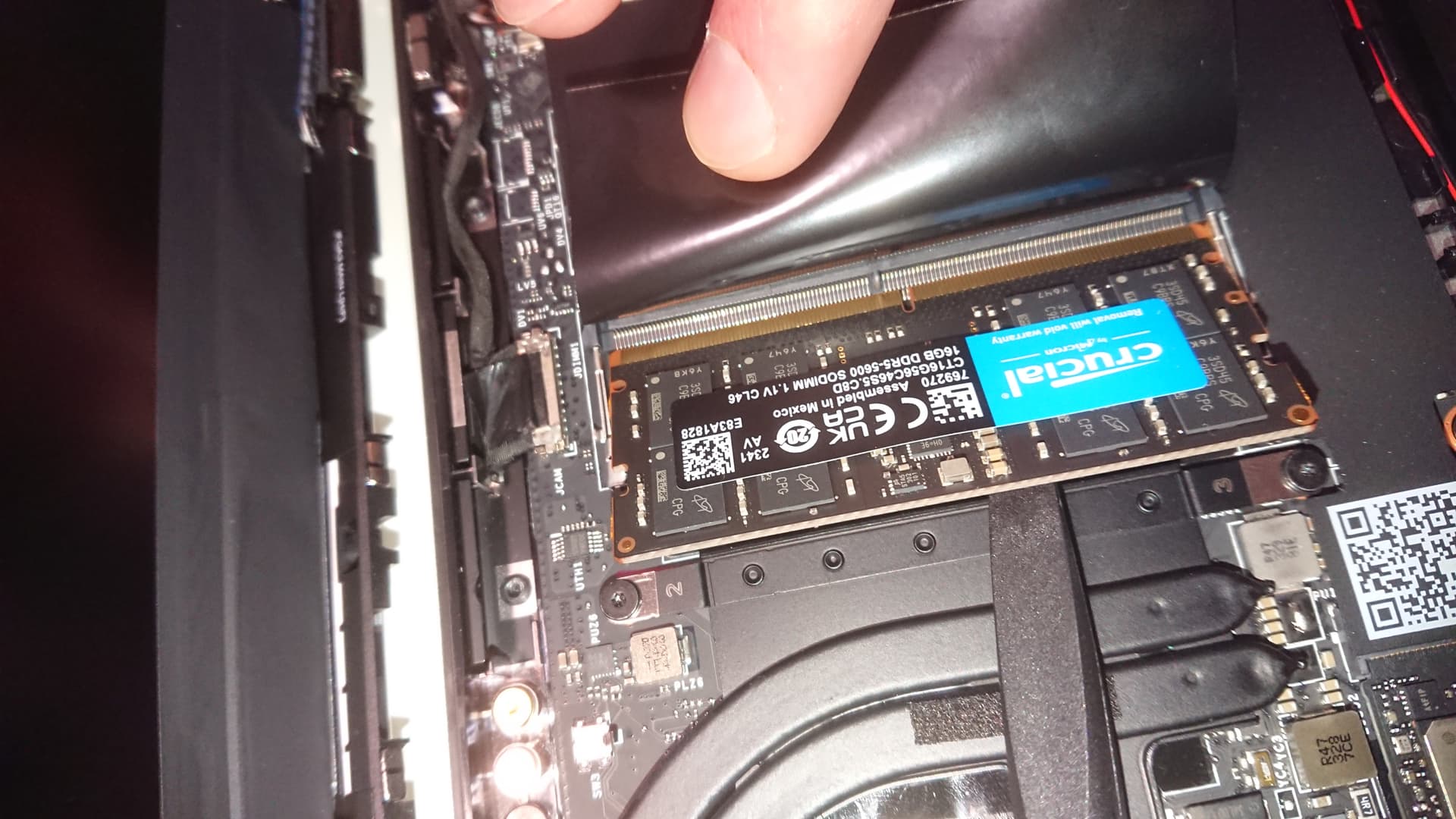

I have received my Framebook 13 and have a problem installing my second RAM module. The first RAM module on the right side can be installed without any problems (according to the instructions).
But not the second module. If I would turn it around so that the chips are facing downwards, then it would fit. But if the chips are facing upwards (as I know and as it worked on the right side), then it doesn’t fit because the slot doesn’t match.
Am I making a mistake or is this a construction/design error or should I really have to install the left RAM module upside down (chips pointing downwards)?

Here an picture:

one of the modules is rotated. The only thing you have to worry about is aligning the cutout on the RAM stick with the nose on the slot - and if the RAM slides in without any/with very little resistance, you’re good to go!

Yes - you just need to turn it whichever way faces the slot.
Usually the RAM slots are symmetrical - the keys in the slots are at the same position on both sides.
This, however, means that one RAM module will be flipped - upside down.
On RAM modules that are only populated with chips on one side, this means that for one module the chips face up and for the other they face down.
That’s completely normal.

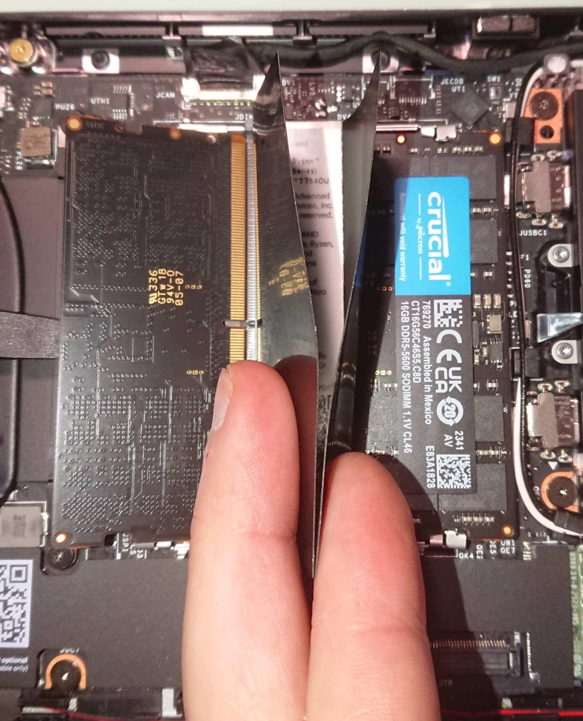

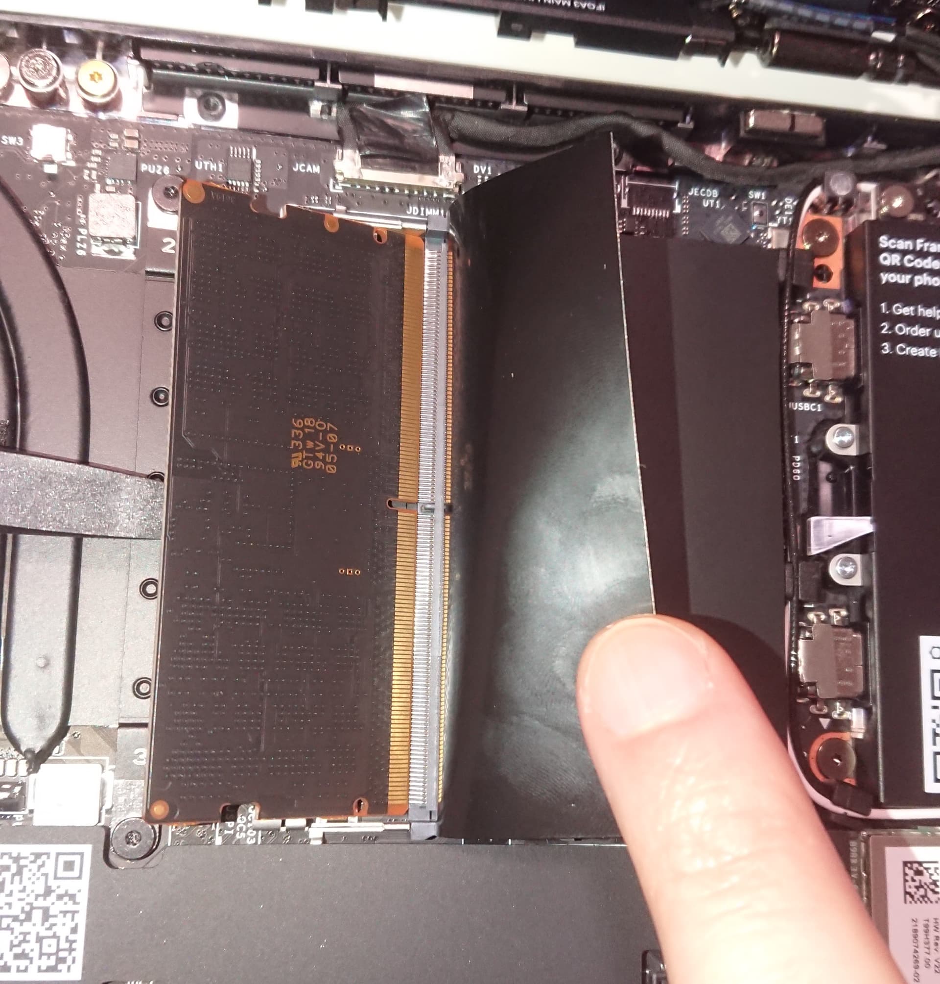

I’ve just seen the attached pictures and that looks correct.
