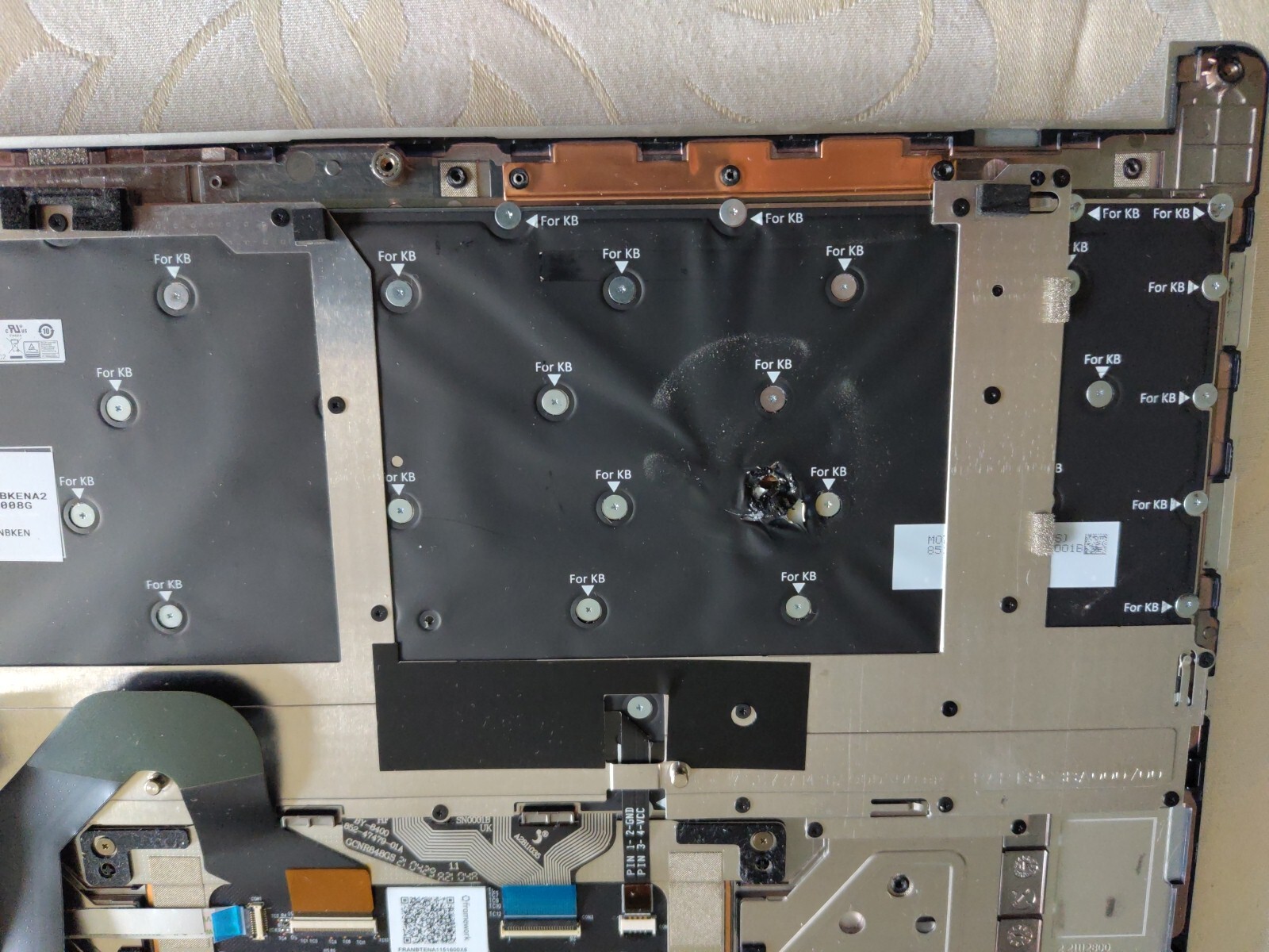

I have a Framework 13", running Ubuntu 22.04.

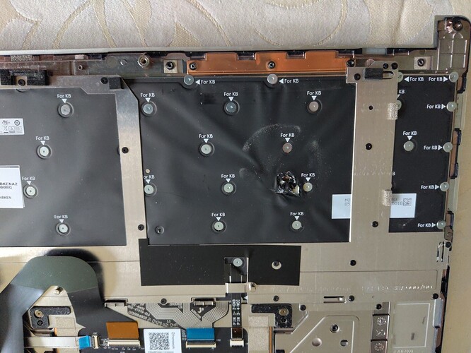

I noticed a burning smell coming from the laptop. I have looked inside and there appears to be some burning on the fan and on the keyboard area just above:
The machine is still working and seems to be behaving normally.
The fan has been noisy for some time - I don’t know if this is connected.

First, I would suggest unplugging the battery until support gets back to you. Or at minimum, unplugging the fan connector.
I think it’s safe to say, he’s dead, Jim.
I would guess maybe a short in the fan.
Glad to hear you contacted support, if you smelled burning, please keep this powered off and support will help address this.
We do have your ticket, so support will reach out from there.
Probably just a short in the fan. But see what support has to say.
You’ll need a new fan at least, but I’d also recommend a new input cover since that was damaged (even if it is working fine for now I’d go ahead and replace it to be safe, I suspect support would also want to replace that).

Sorry I should have updated this before.
Framework sent out a replacement fan and input cover, which was much appreciated. I sent back the broken unit but I don’t know the result of any postmortem they might have done.
Only trouble is now, the replacement fan seems to be having issues too. After a couple of months it started making grating/ticking noises and a few weeks later began ramping up erratically. The fan often comes on full blast and sometimes switches on/off repeatedly, sometimes for a second or less, over quite long periods - and this is usually with sensor temperatures reported around 30-40°C.
Framework support are currently looking into it - we’ve done quite a bit of diagnostics - but the evidence so far seems to be pointing towards a hardware issue. So I don’t know if I’m just unlucky with two faulty fans or if there’s something more serious at stake.

Update: Framework sent out another replacement fan and, I’m glad to say, it seems to have resolved the issue.
