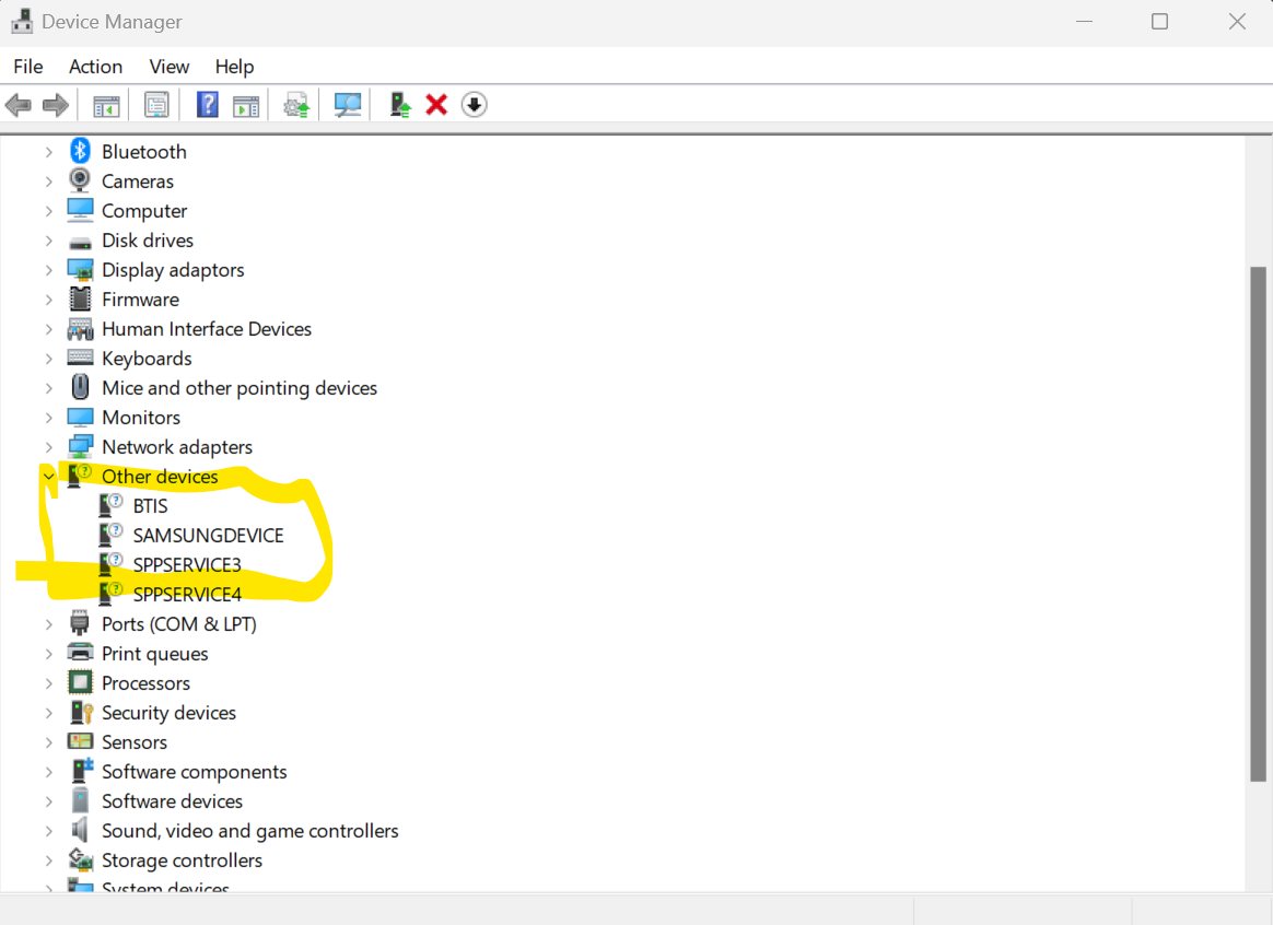

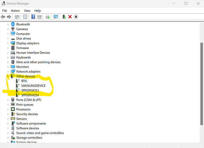

Has anyone been able to figure out what these other ones are?:
I’ve been able to do the ACP USB NODE as described above from the Framework drives after installing AMD’s Adrenaline 24.6.1, but not sure where to point these others at.
The BTIS etc. are Bluetooth headphones.
You probably need to go to the headphone manufacturer’s Web site and get the drivers for it.
Ah, amazing! Thanks for that James, appears they were my Samsung Galaxy Buds Pro. Downloaded the Buds app (originally only had them connected with Bluetooth) & all sorted.
