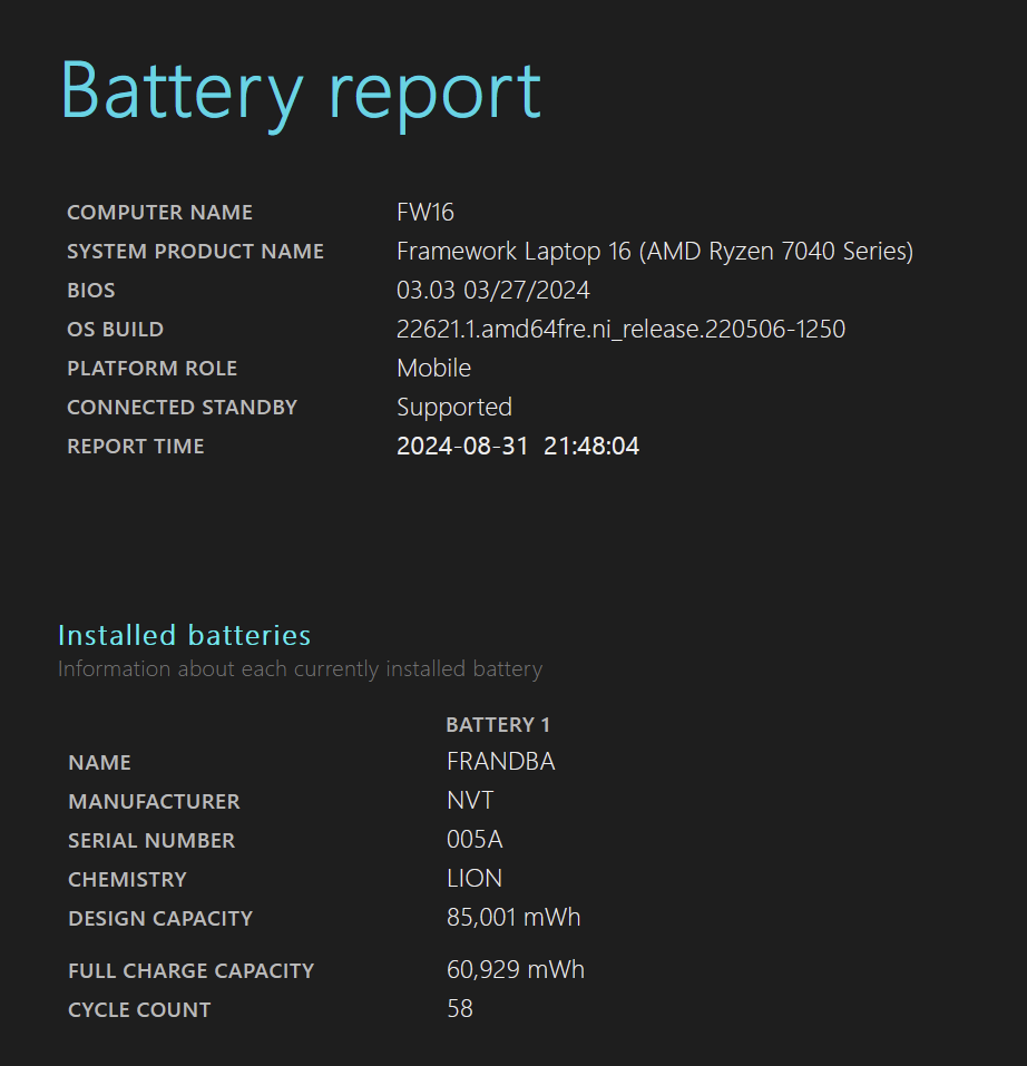

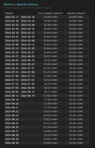

sorry to necro this thread folks but I seem to be having a similar issue. I’m running Win11 on a FW16 with Ryzen 9 7940HS.
I’ve attached screenshots from my latest battery report showing a massive drop in battery health (including reports from March, which is about 3 months before I even bought my Framework), and I tried to do a complete cycle earlier today, but the battery wouldn’t reach 100% and Windows shut down at about 3%.
this post did make me realise that I’m behind on BIOS updates so I’ll report back if I’m still having an issue, but currently I’m on version 27/03/2024. if there’s anything I can do beyond updating BIOS, or if the issue still persists, any advice? thanks in advance!
wuh-oh, seems BIOS was up to date! i now seem to be out of ideas.
This thread is marked as resolved so you’re probably better off starting your own thread. My solution is to leave it plugged in for a number of hours when it’s being dumb. I don’t know if that actually fixes it, but my battery health does eventually go back to 95-100%.
