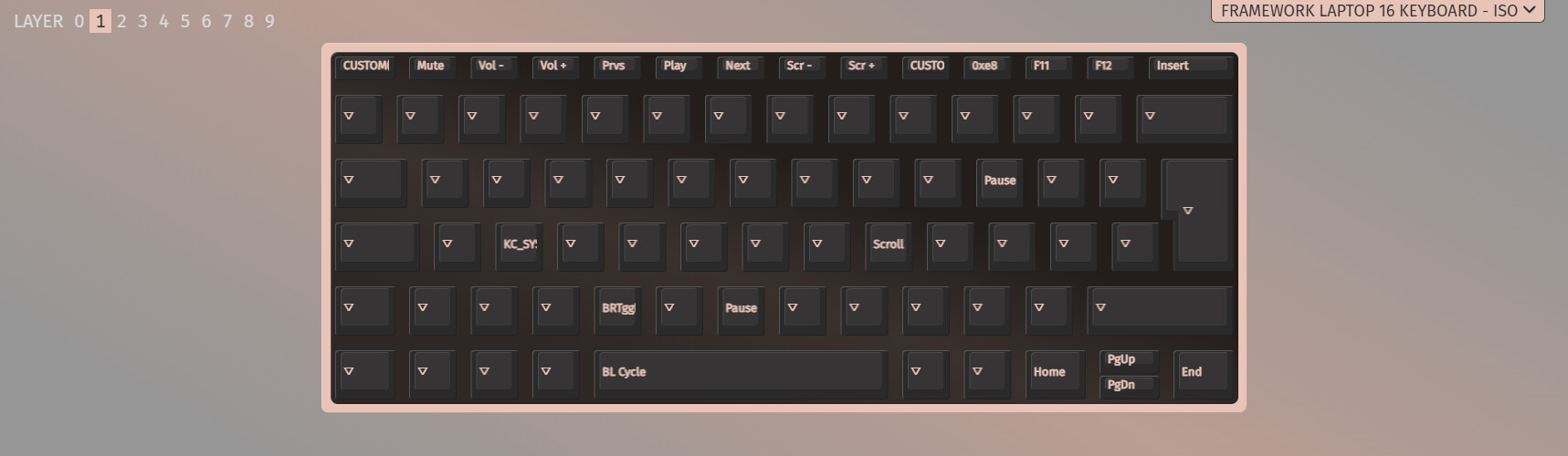

Can you post screenshots of your layers 0 through 3, plus any other layers if you’ve added additional ones?
It’s easiest to troubleshoot by seeing what Via (keyboard.frame.work) shows.
Assignments should be obeyed for F12 & it’s alt function. It’s not special in how it’s handled in keyboard firmware.
Just to be clear, you’re not in Fn-lock, right?
If you do not hold Fn, then these should be your key functions (by default at least)
Layer 0 (zero)
│ESC  │Mut│vDn│vUp│Prv│Ply│Nxt│bDn│bUp│Scn│Air│Prt│App│Del │
On Windows, it defaults to opening your default media player, but Framework’s driver bundle rebinds it to open their site. Not sure why QMK isn’t respecting layer 0 (it should be…) but you should be able to modify what that key does using PowerToys. I believe there’s a registry option that changes what that specific scancode opens but I’m struggling to find it.
screenshots
Here are layers 0 through 3:

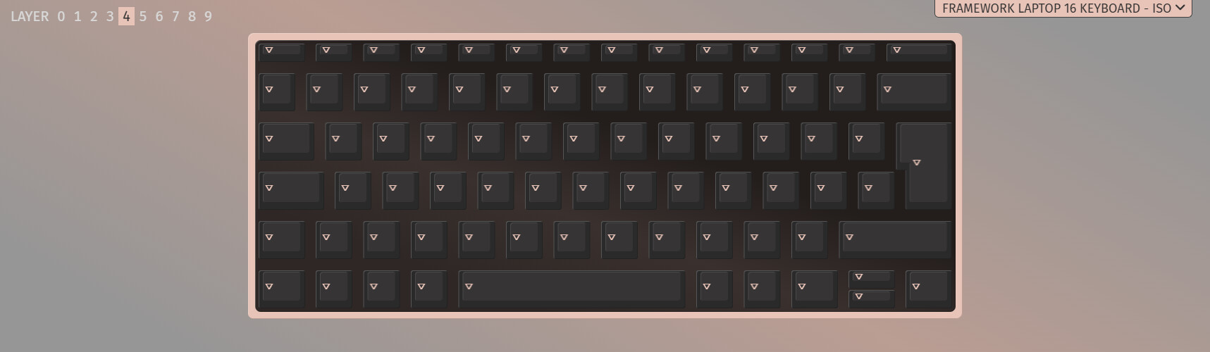

And layers 4 through 9 all look like this:
So far it seems that only layers 0 and 1 are used. I am surprised to see layers 2 and 3 having assignments. When are these used?

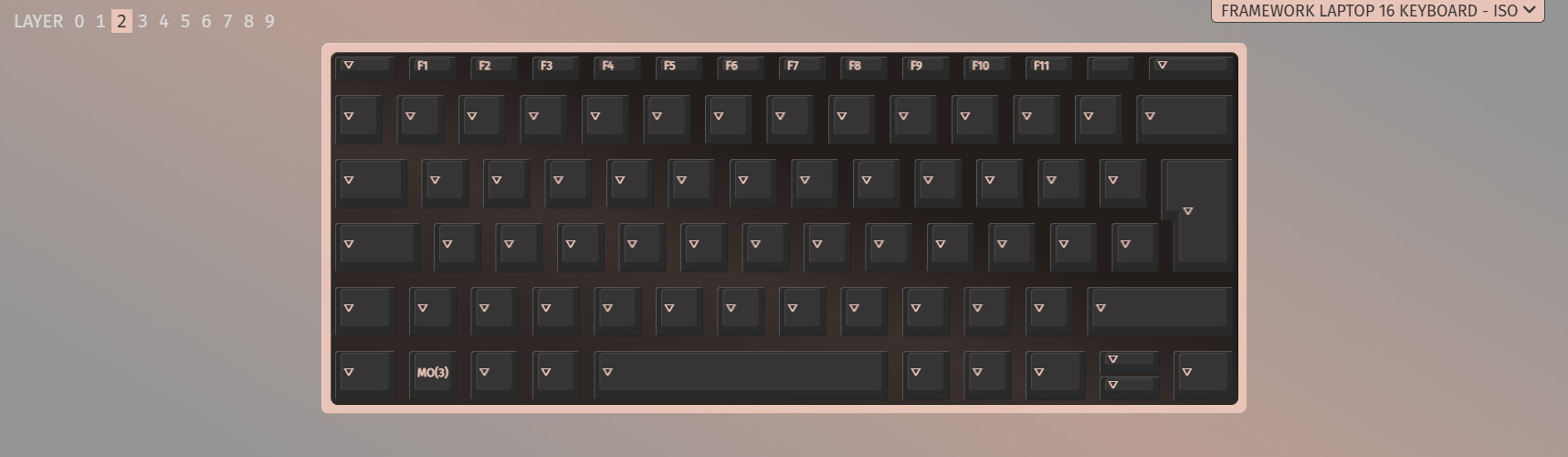

Layers 2 and 3 are your Fn-lock layers. When you use Fn+Esc to switch to Fn-lock, layer 2 becomes your base layer (instead of layer 0), and layer 3 is active when Fn is held down. Pressing Fn+Esc while in Fn-lock switches you back to normal, layer 0 as base, layer 1 active when Fn is held down. (downward arrow) on any key is KC_TRANSPARENT. And means that the keypress is passed through to the next lower level.
Try placing F12 on the F12 location in layer 2 and layer 3. The key currently shows as blank on your keymaps, but for some reason, Via doesn’t show the default media player key (KC_MSEL in the qmk firmware). Because you’ve swapped the F key mapping on layers 1 and 2, one can accidently get into Fn-lock and not be able to tell.
Ah, I see, thanks!
Is this stuff documented (in an end-user-friendly way) anywhere?
When I click on the “Any” mapping in the “Special” section, the prompt is pre-filled with what corresponds to the last key that I clicked. The F12-key had KC_NO in layers 2 and 3 assigned. (And originally, it had KC_F12 and KC_NO in layers 0 and 1 (or 1 and 0; can’t remember now) assigned.)

I then assigned
  • A, B, C, D to layers 0, 1, 2, 3 respectively to the F12 key
  • E, F, G, H to layers 0, 1, 2, 3 respectively to the F11 key

The F11 key works as expected:
  • With FnLock disabled, just pressing F11 types E
  • Holding Fn and pressing F11 types F
  • Enabling FnLock with Fn+Esc and then just pressing F11 types G
  • Then holding Fn and pressing F11 types H
But the F12 key is still broken:
  • With FnLock disabled, just pressing F12 opens the link
  • Holding Fn and pressing F12 presses F12
  • Enabling FnLock with Fn+Esc and then just pressing F12 presses F12
  • Then holding Fn and pressing F12 opens the link
I then assigned Print, F11, Print, F11 to layers 0, 1, 2, 3 respectively to the F11 key, which also works as expected:
  • With FnLock disabled, just pressing F11 presses F11
  • Holding Fn and pressing F11 makes a screenshot
  • Enabling FnLock with Fn+Esc and then just pressing F11 presses F11
  • Then holding Fn and pressing F11 makes a screenshot
So resetting the EEPROM seems to have fixed the F11 key, but not the F12 key.
I honestly don’t know what Via’s problem is. I’ve never been a fan of Via. It’s always seemed to be problematic & lacking to me. Via is made by a separate group from those that make the actual QMK open source keyboard firmware. The QMK devs have been working on their own GUI interface for keyboard config, which would make Via unneeded.
Anyway, your changes seem to be there. But I haven’t been able to find documentation explaining Via layout .json files. Via doesn’t seem to have the same level of documentation as QMK has. At least, that I could find. It seems badly lacking.
But there still are entries in the .json to the original F12 keymap, KC_MSEL. I don’t why it’s there, it could have a valid reason to be there. But you could try changing each entry of KC_MSEL that remains, then loading your edited .json.
KC_MSEL is aka KC_MEDIA_SELECT and this key’s usual function would be to launch whatever the default media player is. github.com/qmk/qmk_firmware/blob/master/docs/keycodes.md. But Framework’s driver bundle sets KC_MEDIA_SELECT in Windows to open their website instead.
Thank you for that suggestion! I did that and was able to change the F12 assignments that way. The F12 key still shows A,B,C,D in Via, but now it works the way I want it to work.
It seems that the Framework-specific data that tells Via which key does what is buggy.
BTW: I don’t see a way of marking the topic as completed/solved/done/etc. and it seems that I can’t edit the title to say “[SOLVED/WORKAROUND]” like other topics have.
I think it would be just a general Via bug.
There is nothing different or special about how the Framework keyboards work in Via versus any other keyboard. Via does not care that it’s a Framework. And the keyboard.frame.work site, I believe, is just a locally hosted straight copy of the Via site code available on Via’s github. They used a locally hosted copy, at least partly because Via devs can be very slow to add new keyboards to their own site. And the Via website needs the appearance of a keyboard to be in its database in order to display it.
