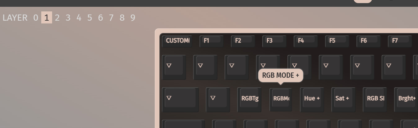

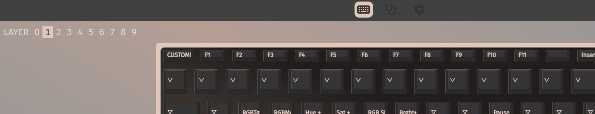

What does the layer 1 default esc key map look like? I have “CUSTOM(65)”
CUSTOM(65) is correct for fn-lock, on layer 1.
But when in fn-lock, which it sounds like you are in, you don’t use layer 1. Layer 3 is your fn layer (again, when when in fn-lock). Do you have CUSTOM(65) there?

Layer 3 has Custom(65) for ESC, but it also has media controls for the F keys… and Im not getting media controls
I seem to be getting actual Fkeys, which seems to be layer 1 or 2 ?
layer 1 also has Custom(65) for ESC, but layer 2 has pass-through
