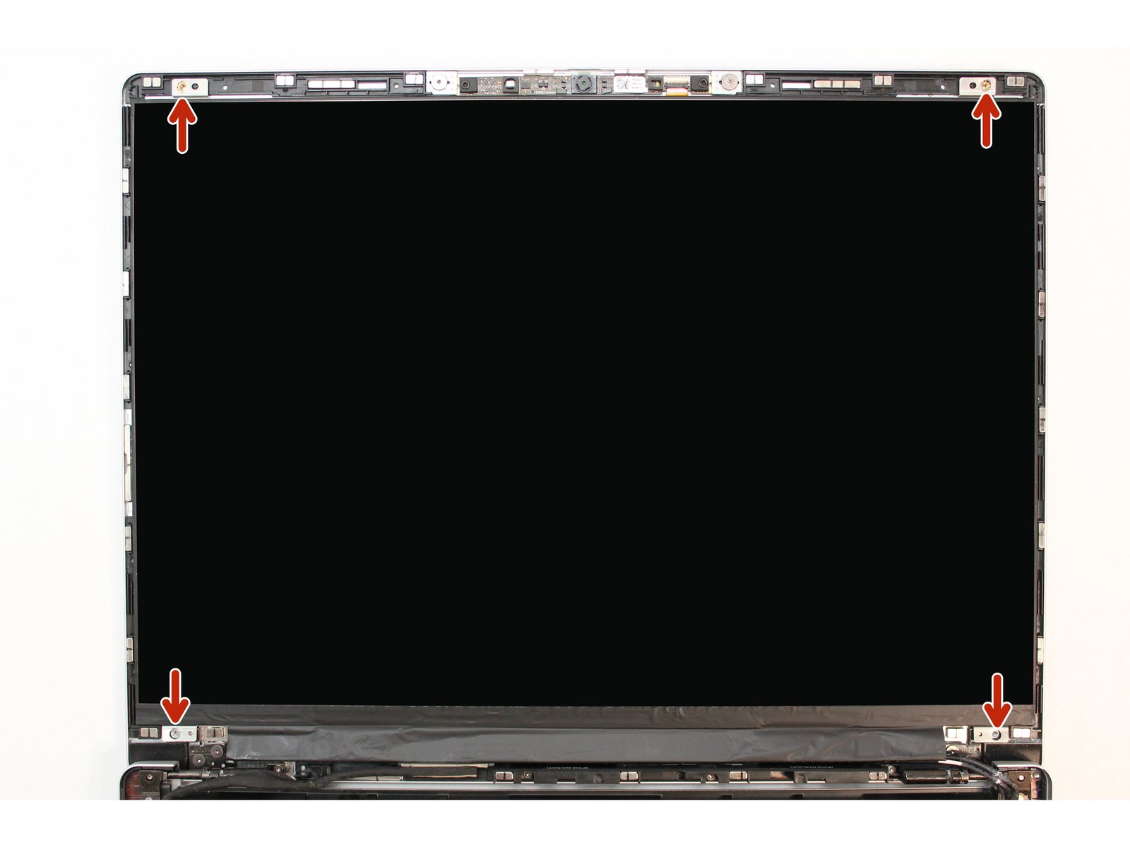

Do they? On the Framework 13 inch models we have:
Screw Type Screws Into
5 external bottom case screws Threaded insert mounted in plastic
5 motherboard screws Threaded insert mounted in plastic
4 hinge screws mounted to the bottom case Aluminum case :tada:
6 hinge screws mounted to the top case Aluminum case :tada:
4 screws attaching panel to case top 2 are threaded insert mounted in plastic. Its hard to tell from the photos what the bottom 2 are.
3 battery screws threaded insert mounted in plastic
1 wifi card screw threaded insert mounted in plastic
1 m.2 ssd screw some grey metal that is attached to the motherboard
5 fan+heatsink screws some grey metal that is attached to the motherboard
From where I sit, only the hinge screws are mounted in a durable fashion. Naturally a threaded insert mounted in plastic should be fine for something like a wifi card but I am quite disappointed that structural screws like the external case screws go into a threaded insert mounted in plastic.
