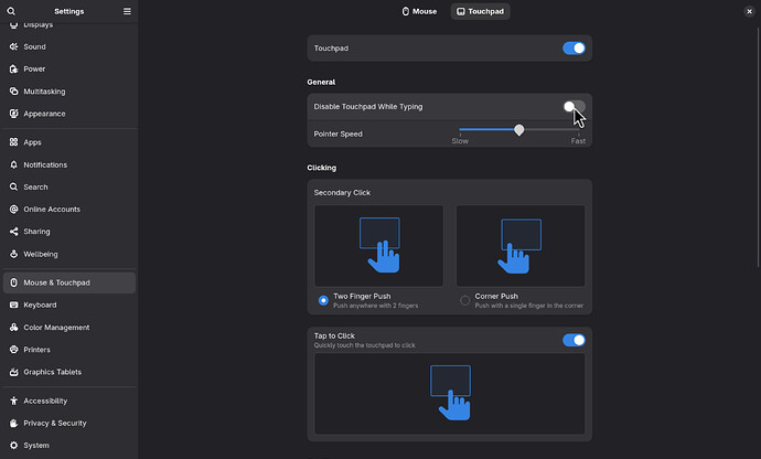

A small update for Fedora users in 2025:
Now this option is part of system settings, and is located in Trackpad section of Mouse and Trackpad settings, as seen below.
