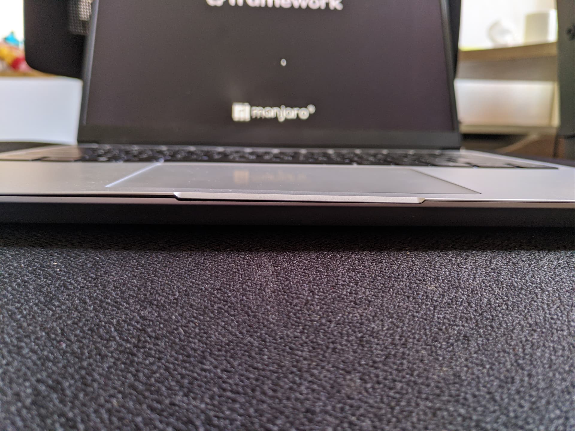

I had the exact same issue on AMD Framework 13 DIY (double clicking on the bottom right corner), and I was able to fix it by putting 7 layers of electrical tape on the bottom right of the underside of the trackpad. Bottom right when seem from below, so opposite of where the double clicking was occurring, see picture.
The only downside is that you can see some pretty major bowing of the laptop now, see picture. Please share your info if it worked for you / if you found a way to fix the trackpad without the chassis bowing.
