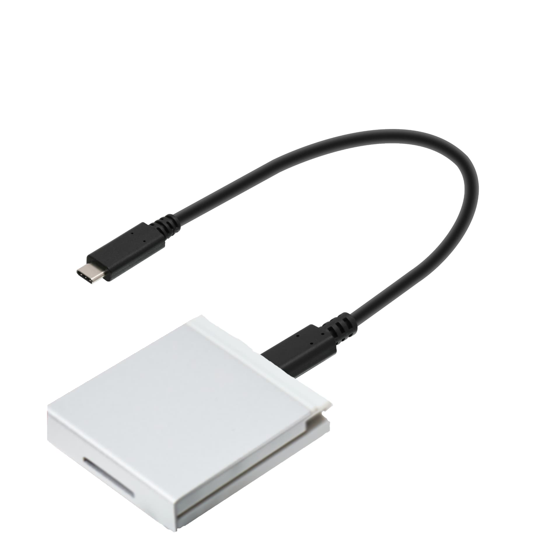

So you’d get something like this.
(SD-card module)
@anon81945988 I’m searching for USB-C Male to Female, thanks though! One end should be like this.
(basically a receptacle)
Because the Expansions Cards have a Male connector on the end. (Which connects the dongle to the computer)
