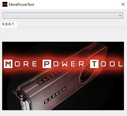

More Power Tool detects nothing at all.

Also, as written in the compatibility table, MPT is not compatible with RDNA3 (aka the 7000 series).
I know what it said but I still went to check.
