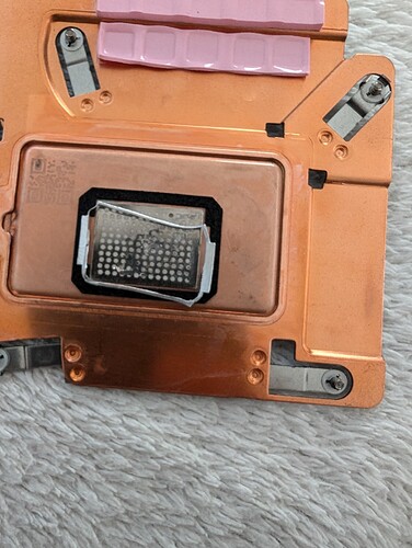

I lapped my heatsink and bought some unverified PTM7950 on Amazon like @PSierra117. With the new cooling solution I have gotten above 16k in single cinebench runs and the fans take noticeably longer to ramp up. I am attaching some images of the original liquid metal and lapped heatsink.

What did you use for lapping the surface?
I used a 600 and 1200 grit diamond stone after covering the surrounding area with tape.
