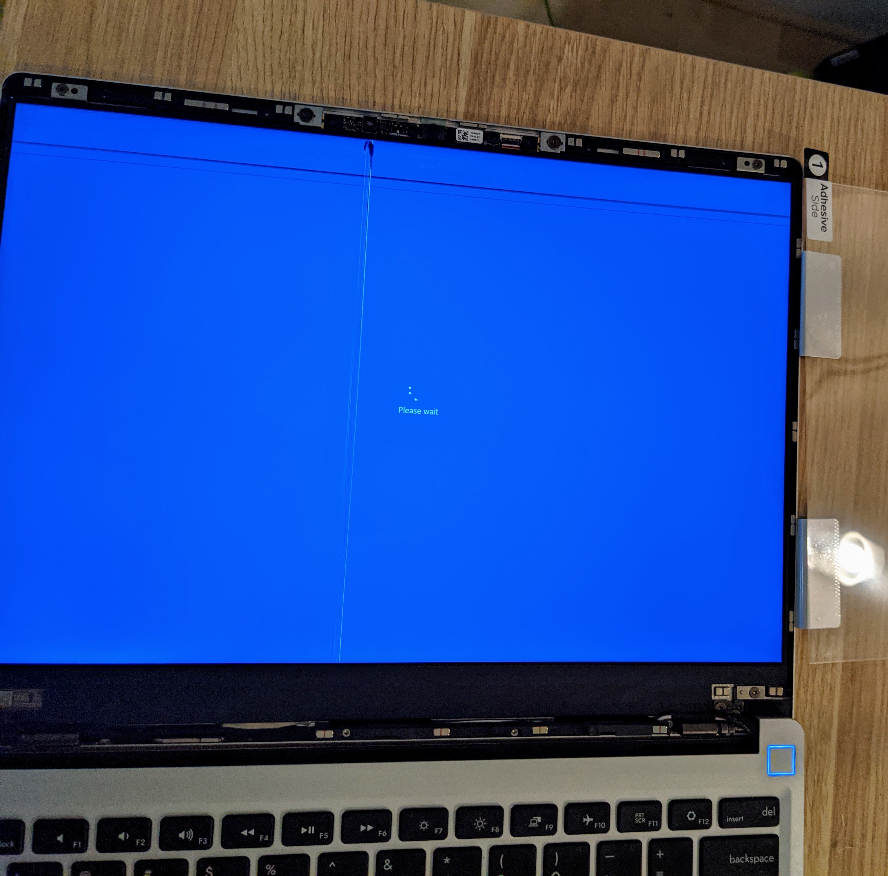

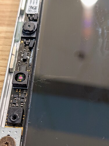

I bought a Via Screens screen protector specifically for the laptop.
While using the “Pre-Application Dust Remover”, the adhesive felt like it was too strong.
When I pulled it up from the panel, I was left with a faint mark:
Turning the laptop back on, I was greeted with this:

Whoah :open_mouth: okay maybe I’m cancelling my order for the matte protector then, has anyone else run into this?

I think the alignment tabs and dust removers are the same across all products - they’re just stickers. The tablet likely has at least another layer of glass on top of the screen, which could be coated in something that reduces the adhesion of the sticker (e.g. oleophobic coating). The strength of the adhesive wasn’t nearly as strong on the tablet.
If you watch the ViaScreens instruction video for laptops, they use a laptop with a screen that’s bonded behind a layer of glass. I’m not sure if ViaScreens actually tested this exact product - which would be irresponsible IMO.
Yikes. I have installed both Via and Photodon screen protectors, but avoided using the adhesive dust collectors for this reason. Going into a dust free environment and using only lens cloth to wipe away smudges and dust should be ok. We’ll add a warning around this in the Knowledge Base.

I used all the stickers and didn’t have this happen to me. Granted it’s still a nightmare to get all the air bubbles out but I kept the bezel on after hearing a story about someone breaking their screen from installing a ViaScreens protector with the bezel off. Maybe this is the same issue?

Man, sorry to see that. Very frustrating, to say the least. I put the Via Matte one on and also found the dust remover to be extremely sticky. It should be more like a Post-It, and less like duct tape. In fact, it also left some residue on the screen that I had to carefully clean off. I gave up on it after that and was just very careful with the wiping and dust.

I was unlucky and this happened the first time I used the dust remover on this screen.
Once I replace the screen, I don’t think I’m going to try this again without the dust remover.
I would imagine that attempting to remove the screen protector would destroy the LCD if not done very carefully.
