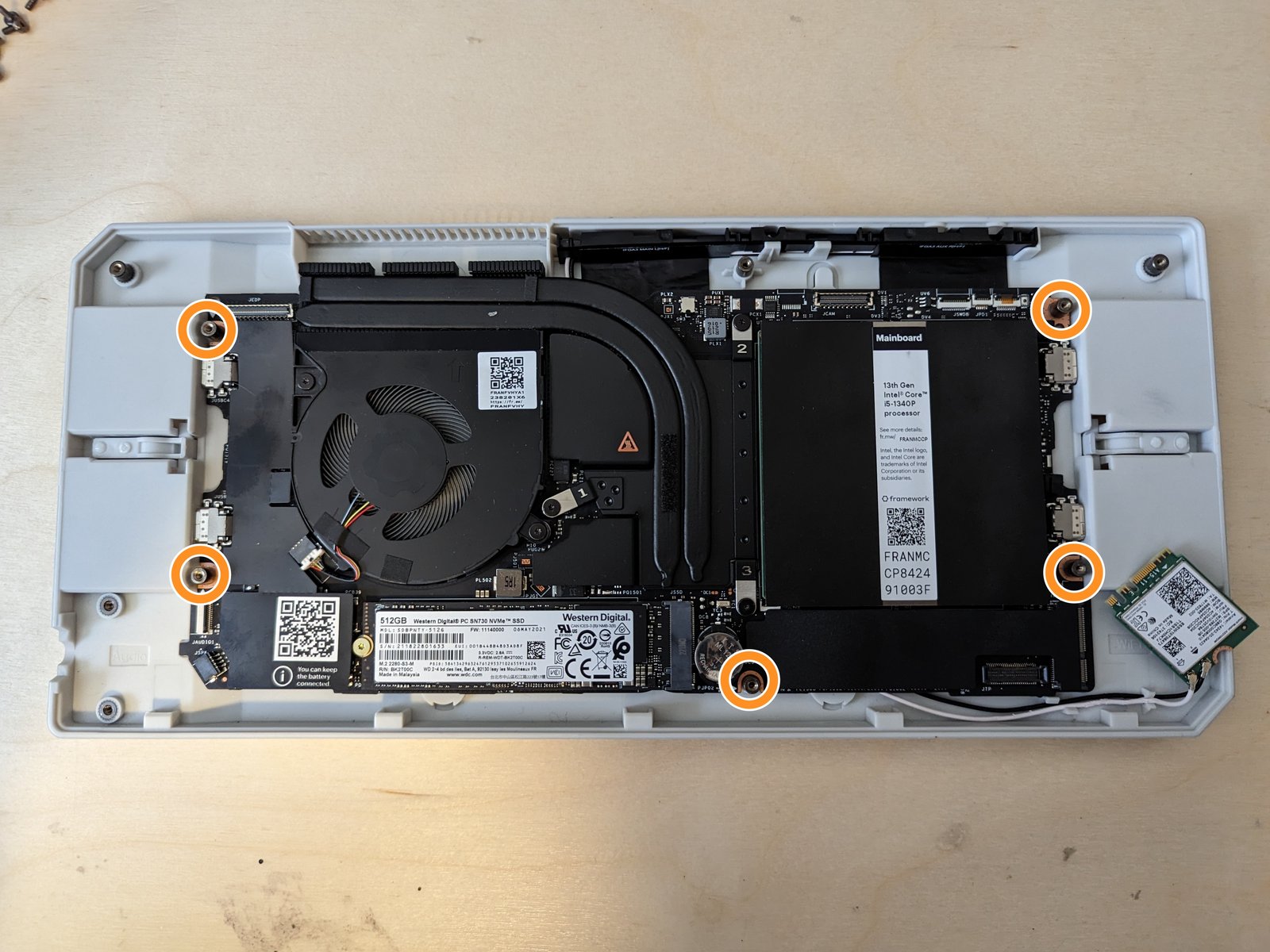

From Mainboard Replacement Guide, Step 10
Though it looks like that should be a problem with the laptop case too. Haven’t noticed anyone mention issues there.
