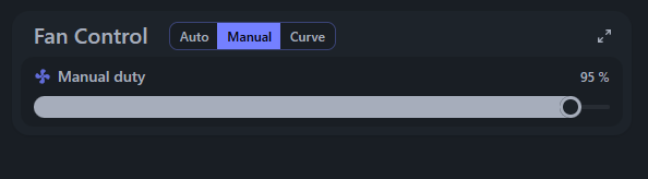

I did a new test. I set the FANS at 95% speed (extremely loud!!!)
The results were shocking: The system thermal throttled with PROCHOT_EXT even with cpu and rams at 65 degrees celsius…
In the photo i did not manage to catch the flag PROCHOT_EXT flag to 1 (my bad, i did the screenshot in the wrong moment) because the flag oscillates between 0 and 1 but we can see that the CPU is limited at 20W with a frequency of 1253 MHz!!
Another thing was that i set a TDP Limit to 40W to the CPU so not even running at “full speed”.
I don’t know what is wrong with this machine…
