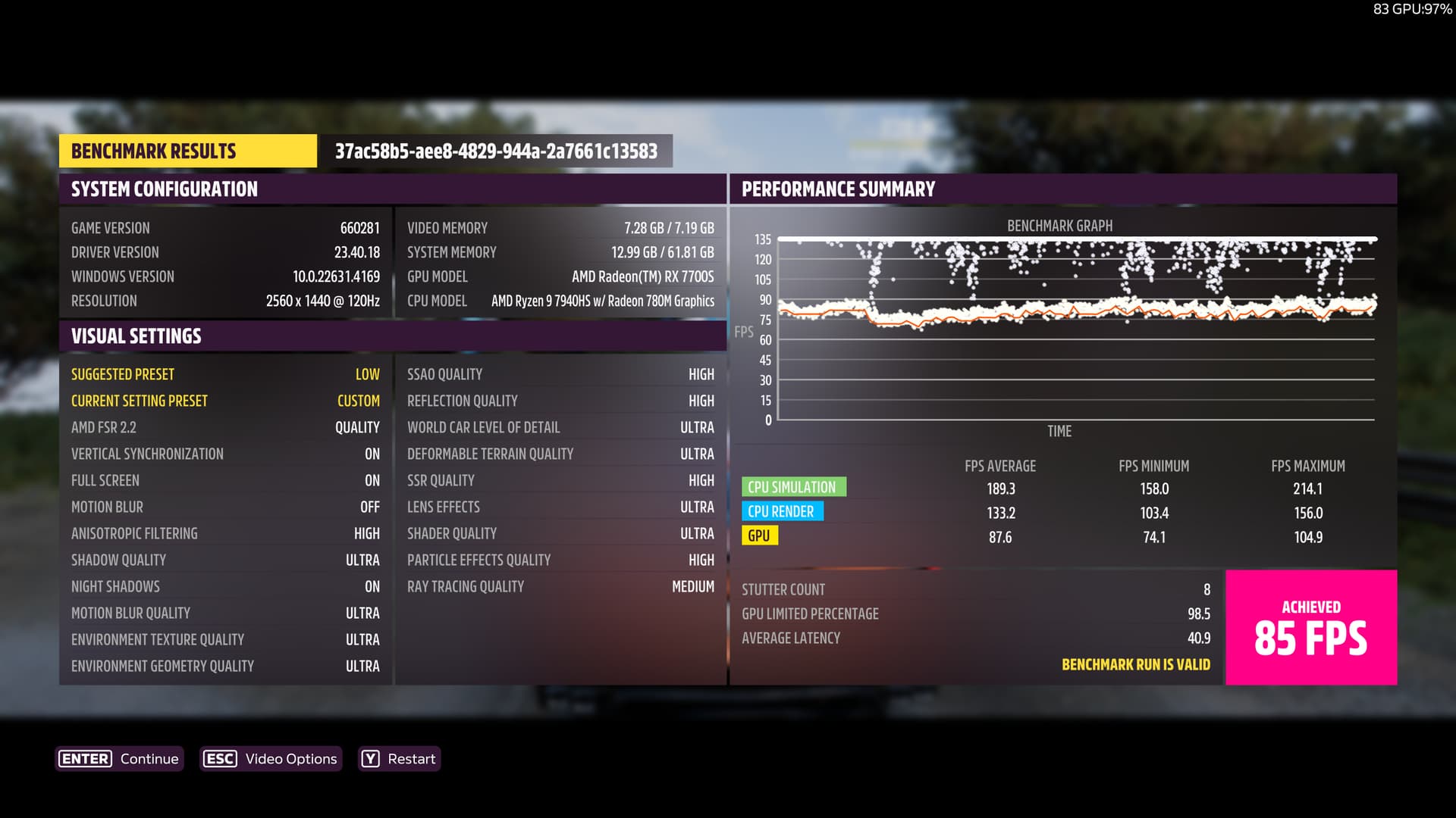

In case anyone is interested to see what happens when this issue occurs, I ran a few benchmarks in Forza horizon 5 using both the Framework and Anker charger (Using the balanced profile in windows):
Anker - 140W:
Framework - 180W:
A little edit:
It DOES work when using “Dual Laptop mode” (This charger has multiple modes), which prioritizes the main two ports!
It’s still slightly slower than with the 180W Framework charger, but it does work fine without stuttering, getting 71FPS in the same benchmark with nearly no stuttering!

Now that’s real interesting, here’s the results:
C1 prio: 140W (28V) => 40FPS, heavy stuttering
C2 prio: 100W (20V) => 70 FPS, no stuttering (?!)
C1 Dual laptop: 100W (20V) => 70 FPS, no stuttering
C2 Dual laptop: 100W (20V) => 70 FPS, no stuttering
The charger indeed doesn’t do 140W in dual laptop mode (good catch!), both C1 and C2 are at 100W max. Worth noting that at 100W, the battery does drain ever so slightly (I was at 95% after a few runs of the benchmark, so ~10-15min)
