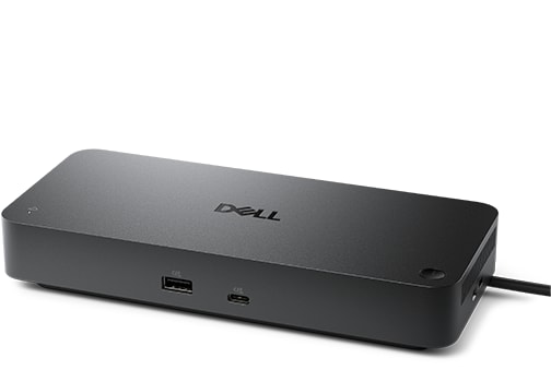

Oh wow, this is cool! This is the dock I’ve been waiting for!
I bet it’ll have crippling firmware and compatibility issues and you wouldn’t really want to use it with anything other than a Dell. That’s how it’s been with every Dell dock for as long as I can remember
What you are describing is HP docks to me. My Dell dock is miles better than 2x the price HP one and gets firmware updates regularly on LVFS.
And, at least from the manual, it seems that they haven’t locked any features behind Dell own hardware, only added on top of what PD/USB doesn’t have, unlike HP.

300W (Dell Systems)
240W (non-Dell Systems)
So I highly doubt that Dell dock would ever do more than 240W for Framework computers, unless someone at Dell specifically reaches out to Framework to discuss working on that proprietary protocol together.
The USB-C standard only goes to 240W at this time, and Framework has historically been against doing anything proprietary whenever reasonably possible.
