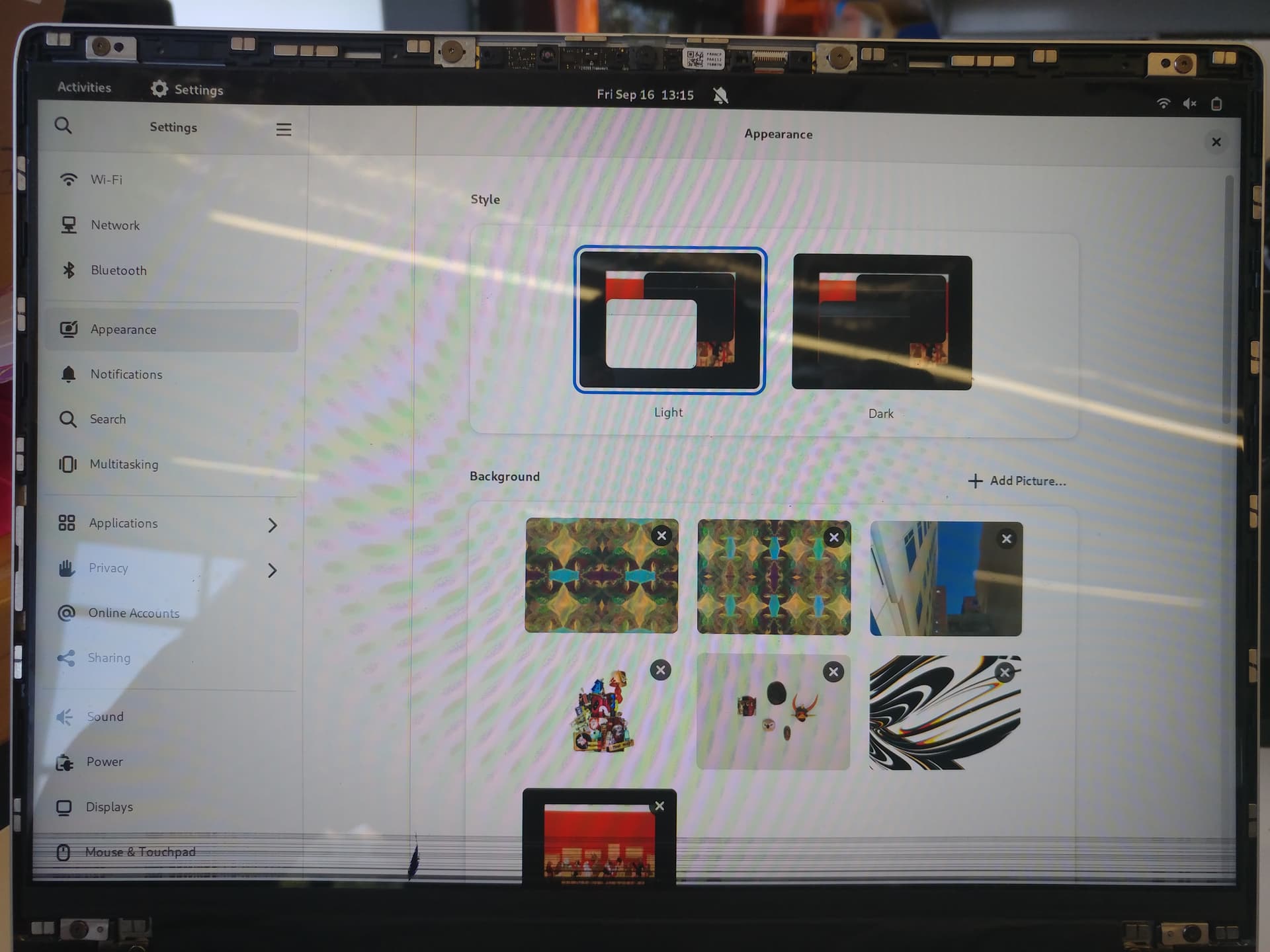

Ended up breaking the display while replacing my hinges. I must have pulled too hard when separating the display from the bezel adhesive.
My question is why is there adhesive on the plastic bezel? I think the magnets are enough to hold the bezel in, and taking the adhesive off would prevent accidental breaks like this. For a piece that is supposed to be easy to remove, I don’t think adhesive is necessary.
Display for refence:
Where is the breakage on the disply. The image doesn’t make that clear, or dom you mean the output of the dispaly rather than the screen?

There is a very light adhesive tape on the bottom edge of the bezel I found out the other day. It doesn’t require much force to separate from the display. Definitely wouldn’t think enough to cause the type of pressure needed to cause what’s pictured.

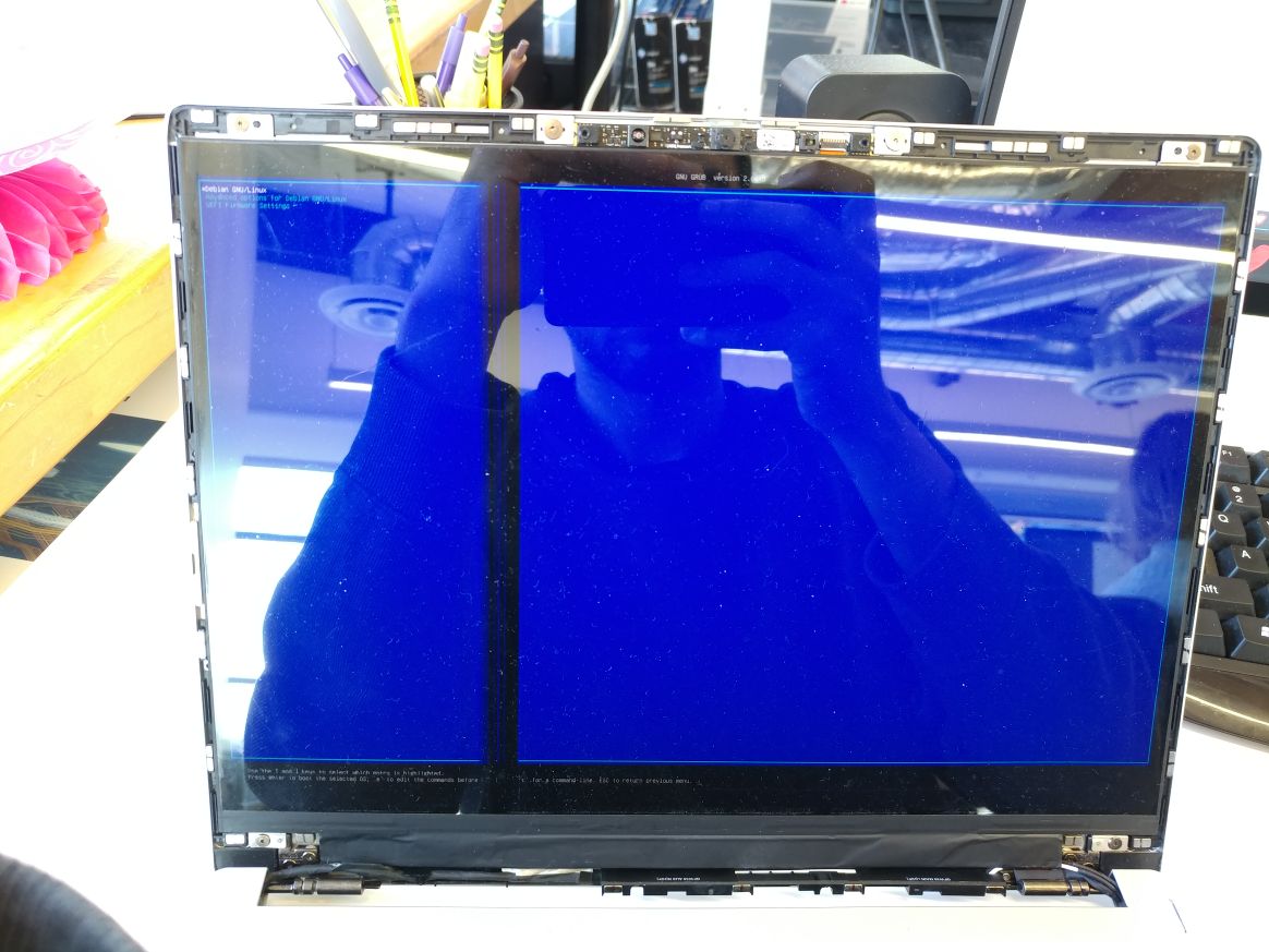

Sorry, here is a better contrast photo. It is mostly along the bottom edge, but also has a line going vertically:

Couldn’t be the display connector, could it?

I wonder whether the damage was caused by finger placed in between the bezel and the panel, using the panel as a leverage point for the finger to pull / lift the [lower portion of the] bezel off.
@Second_Coming I was pulling on the bezel with the display screwed in. According to @TheTwistgibber even though I was pulling on the bezel, the adhesive shouldn’t cause any damage to the display. I don’t really know what tape they used or what it is rated at, so kinda have to take their word on that
