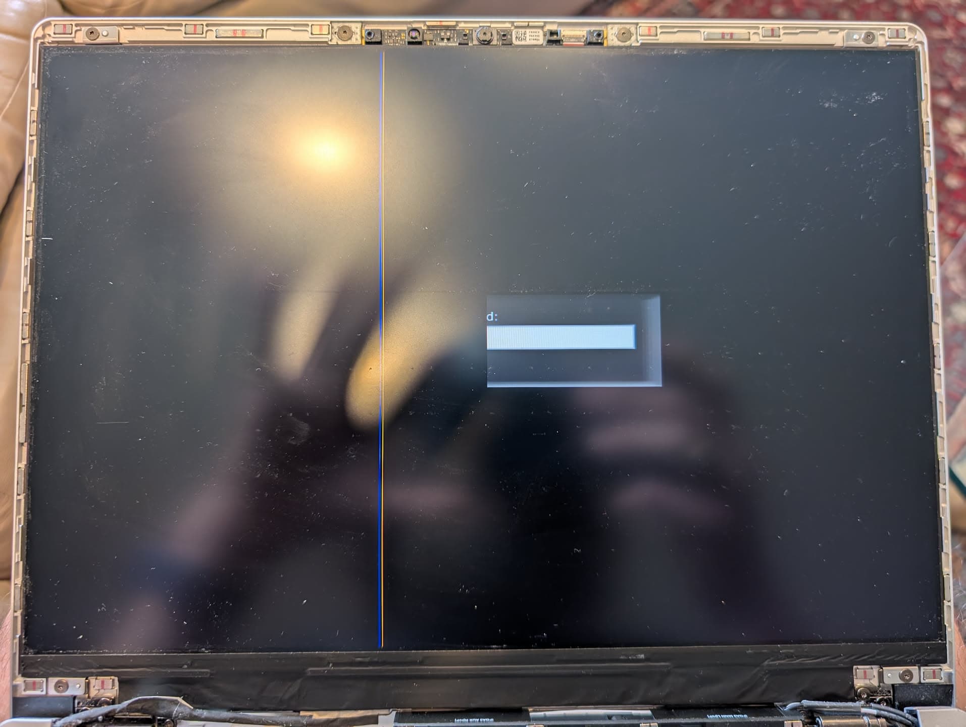

I recently bought a new trackpad, hinge, and bezel. First two were for wear/tear, with the latter upgrade for aesthetics. After replacing the hinge, I noticed that one segment of the display was dead except for a red line:

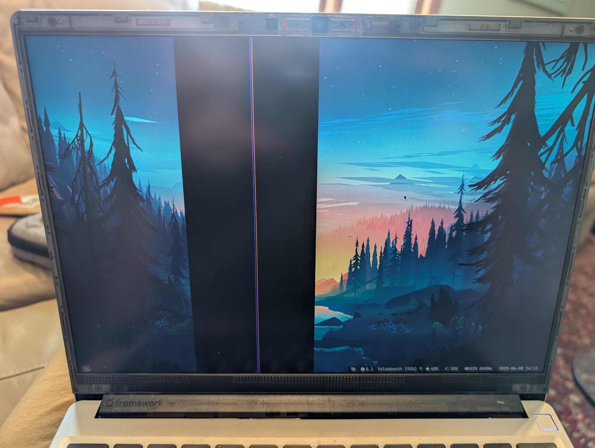

Unfortunately, it seems as though the adhesive holding the bezel damaged. Pressing lightly on the bottom of the display causes some change to the red line. Here’s a picture with the laptop fully booted to show that the first segment still works okay:
I re-seated/blew out/wiggled the display cable many times, so I don’t believe thats the cause, although I could be wrong. You can see some adhesive lines up perfectly with the damaged area, and it clearly pulled apart the black wrapped section:

You said you replaced the hinge and bezel.
Did you replace both sides hinge?
I am thinking that if only one side was replaced, it might have put uneven pressure on the display and maybe caused this. I am mentioning it in case it might cause the same problem when you get a new display.
Nope, both sides! They were both shot to hell.
