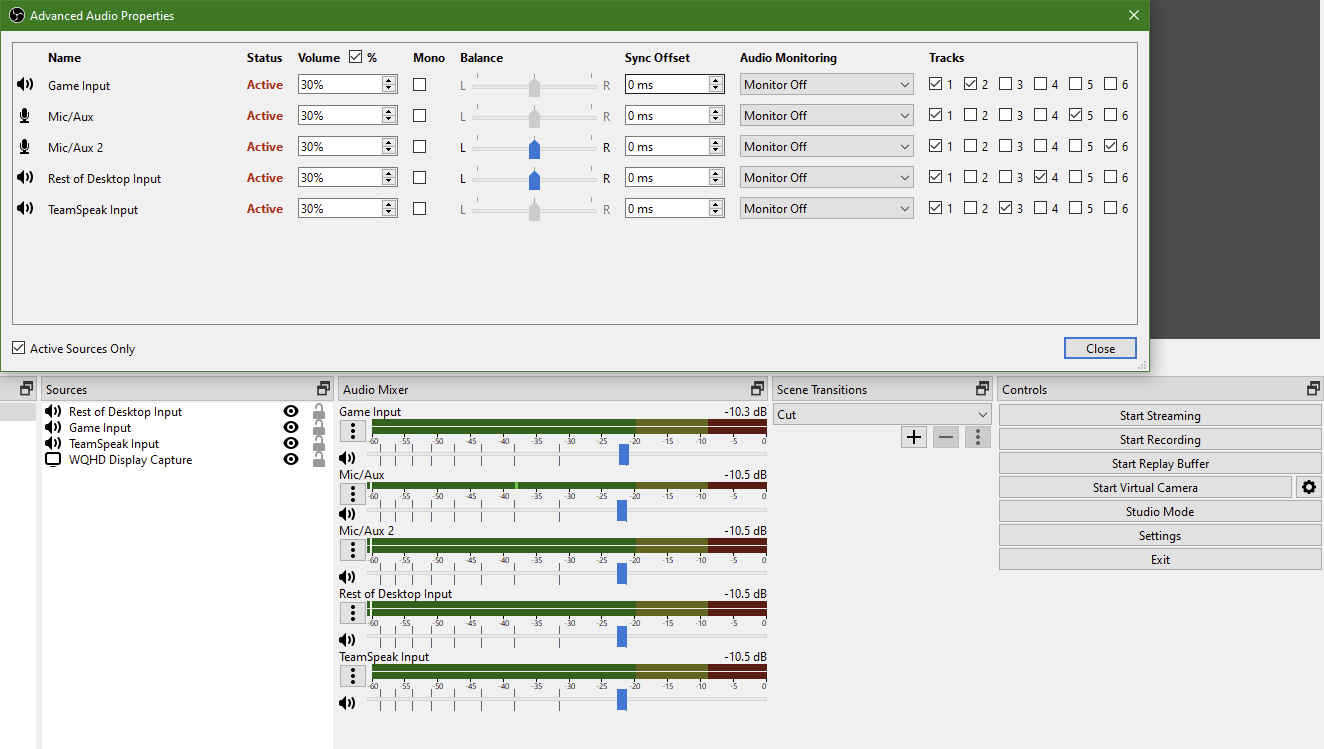

Go to Settings -> Output -> Recording -> Recording Settings -> Audio Track and check all numbered checkboxes. Then in Settings -> Output -> Audio give those tracks appropriate names. I highly suggest something like “Mixed audio” for the first track, and then I have “Game”, “Teamspeak”, “Desktop”, “Microphone 1” and “Microphone 2” for the other tracks.
Go to Settings -> Audio -> Global Audio Devices. I don’t really know why this exists in the first place, but here I have “Mic/Auxiliary Audio” set to one microphone (external) and “Mic/Auxiliary Audio 2” to a secondary microphone (laptop-integrated), and everything else “Disabled”.
At Main Window -> Scenes, click the plus button, name it something like “Gaming on external screen” and confirm with “OK”.
At Main Window -> Sources, click the plus button, select Application Audio Output Capture (this is the plugin), select “Create New” and name it e.g. “TeamSpeak Input”. In its settings, add the executable “ts3client_win64.exe” to the list of executables (either manually, or by selecting that executable on the bottom and clicking “Add executable”). If you are using Discord, it’s probably called “discord.exe”. You can add multiple here (e.g. Parsec, Skype, etc.). Confirm with “OK”.
Create another input and name it e.g. “Game Input”. Add the executables of the games you play (e.g. “r5apex.exe”, “factorio.exe”, etc.). Confirm with OK.
Create another input and name it “Rest of Desktop Input”. Add all the executables from “TeamSpeak Input” and “Game Input”, then make sure to enable the checkbox “Capture all audio EXCEPT sessions from the selected executables”. Confirm with “OK”.
At Main Window -> Audio Mixer, click on the gear button. I recommend reducing all sources to 30%, because if you are shouting, your friends in TeamSpeak are shouting, and the game is loud, the “Mixed Audio” track might be clipping. You should experiment with this. In the “Tracks” section, enable track 1 for all sources, so that track (which is you named “Mixed Audio” in the settings) will receive all audio. And for each source, check the corresponding single track. For me, this looks like this:
