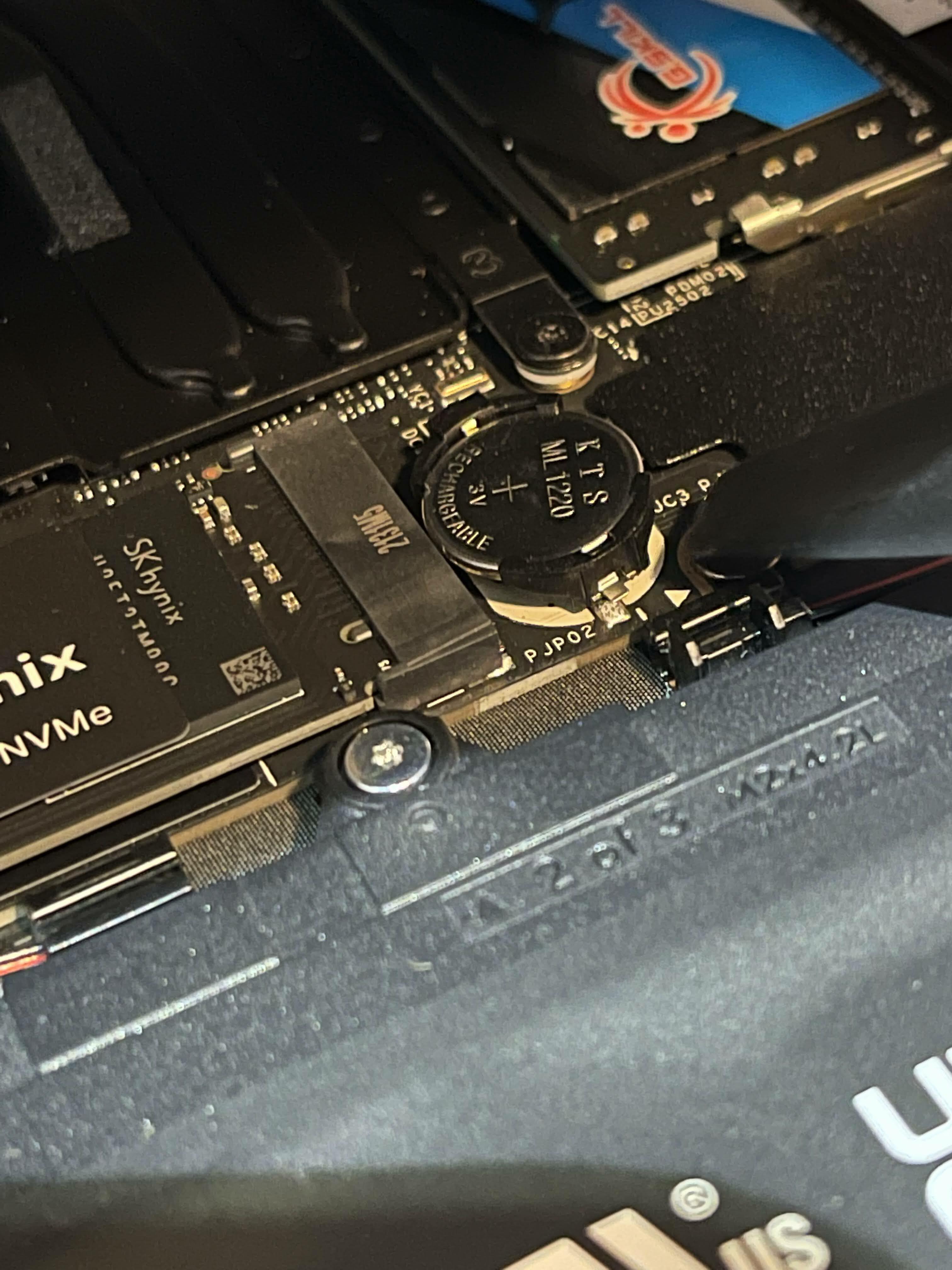

Another quick update. I think I found the issue, and I suspect it is hardware related. I believe that my bios / cmos battery is not properly soldered to the motherboard. I can clearly see the pad not being connected to the solder, and it moves around if I touch the battery. I have ticket open with support, so I will report back on if this is normal.

For my issue, Framework is sending me a replacement motherboard since the battery holder is not properly attached.
