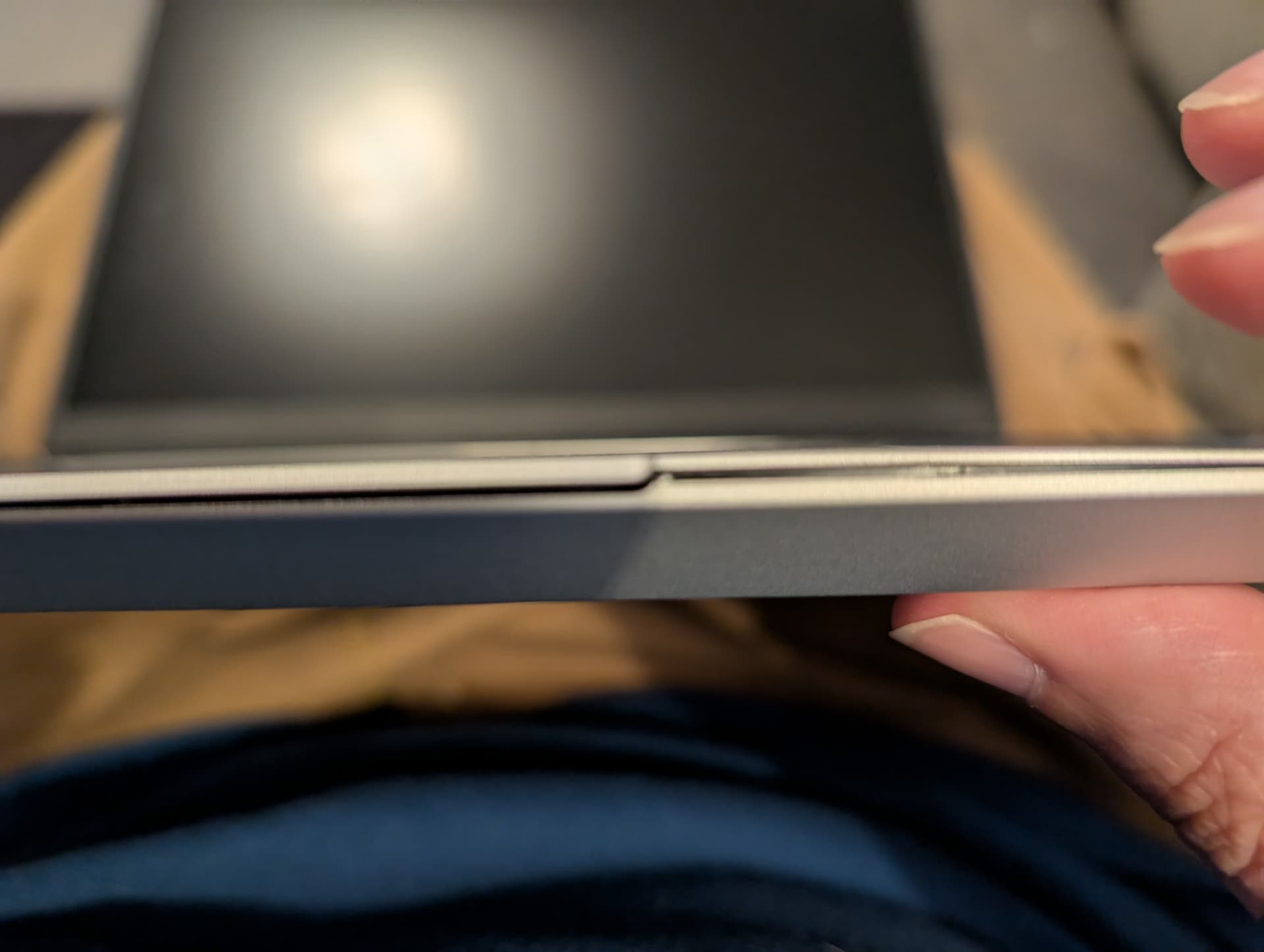

I’m running a Laptop 13 (Intel 13th gen) and I’m experiencing an issue where the front of the chassis (by the mouse pad) buckles as the laptop gets warm. Generally, there’s no gap but as I use the machine and it warms up, the chassis buckles, making the touchpad unusable as clicks aren’t registered or there are phantom clicks as my palm presses down on the buckled area.
Any suggestions for resolution on this? It’s making it pretty unusable at this point.

The image is just me holding it up. When it’s powered off for a few minutes and cooled down, the gap disappears. It starts showing up under use and gets worse over the period of an hour or so and then reaches a max of a few mm, which is enough to impact how the touchpad functions.
You can plan to say goodbye to your battery (order a replacement). Swollen 61Wh batteries with Framework is a thing.

That looks swollen to me - but double-check. I would suggest reaching out to Support, the battery may be replaced under warranty. If it is swollen, I would suggest removing it from the machine and disposing of it someplace that will take batteries, and informing them that it may be faulty. Those things can combust and are not pleasant to deal with.
This is 100% swollen. Please contact customer support immediately, and if possible discontinue using the laptop. You can actually remove the battery and use the laptop without out it using the AC. You would need to enter the BIOS and enable standalone mode though. Do that before unplugging and removing the battery.
That is a spicy pillow. Time to replace.
Yours is definitely swollen. If it’s visibly swollen then it’s without a doubt time to get it replaced and to contact customer support if there is other issues that affected the battery to swell as well.
