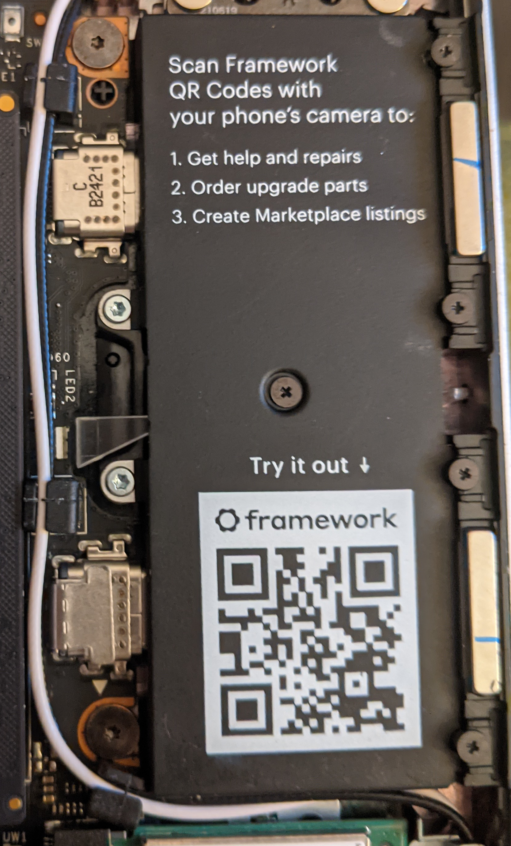

Thinking now that my thread Ubuntu 21.04 Lagging (particularly touchpad) after a decent amount of uptime? - #7 by John_Flatness is related to this one, I opened up the machine to check those stickers (it’s a Batch 2).
I noticed a couple odd things, and given them I didn’t actually complete the recommended process.
On the left side the top port that seemed to be most at issue had a kind of loosely-attached sticker on it. The bottom one as far as I can see doesn’t have a sticker at all. I haven’t fooled around with these so it must have come like that. Photo follows (it’s a little hard to see on the picture but that top sticker is kind of barely stuck on there):
On the right side, similarly only one of the ports seems to have a sticker, this time it’s the bottom one.
Ultimately all I did was push the top-left sticker down more firmly onto the top of the port and close the laptop back up. Hard to say if that’s had any effect since the problem is kind of unpredictable.
Anyway, is this “2 stickers” situation normal? It doesn’t seem to match the photo or text in the knowledge base article.

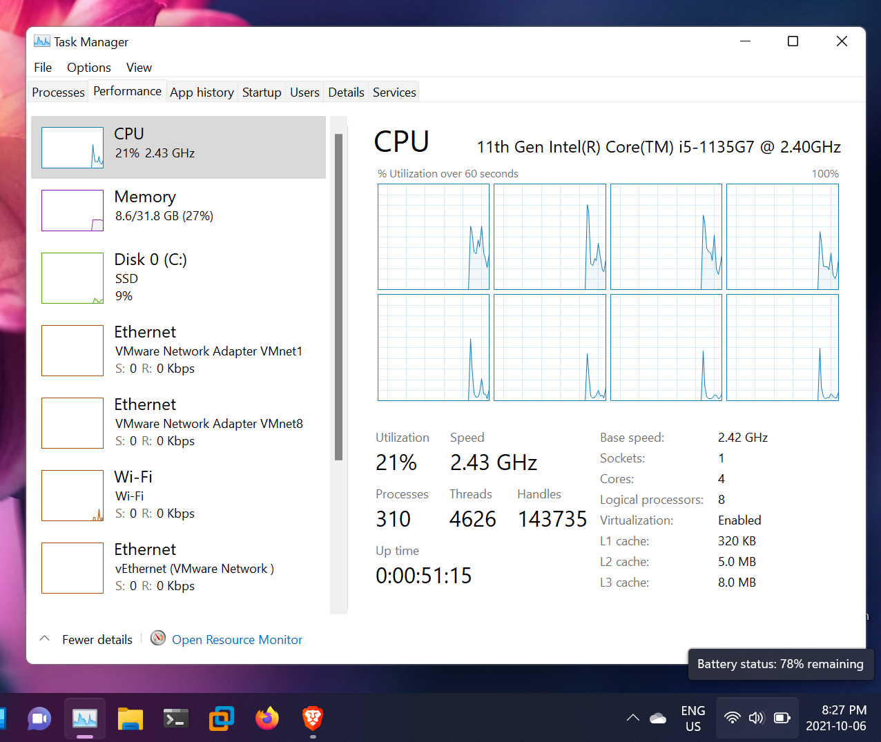

Probably not necessary, but maybe helpful - Here is a screen recording of it along with a log. Going from 13% to full charge. It happens for me at 74% in this test and the clock begins to recover at 83%. My thought is it has to do with when the charger switches from constant current to constant voltage. It’s very interesting that the clock changes practically at the same time that the percentage display ticks over from 73% to 74% and from 82% to 83%. Could be a coincidence.
Screen recording:
Log:
