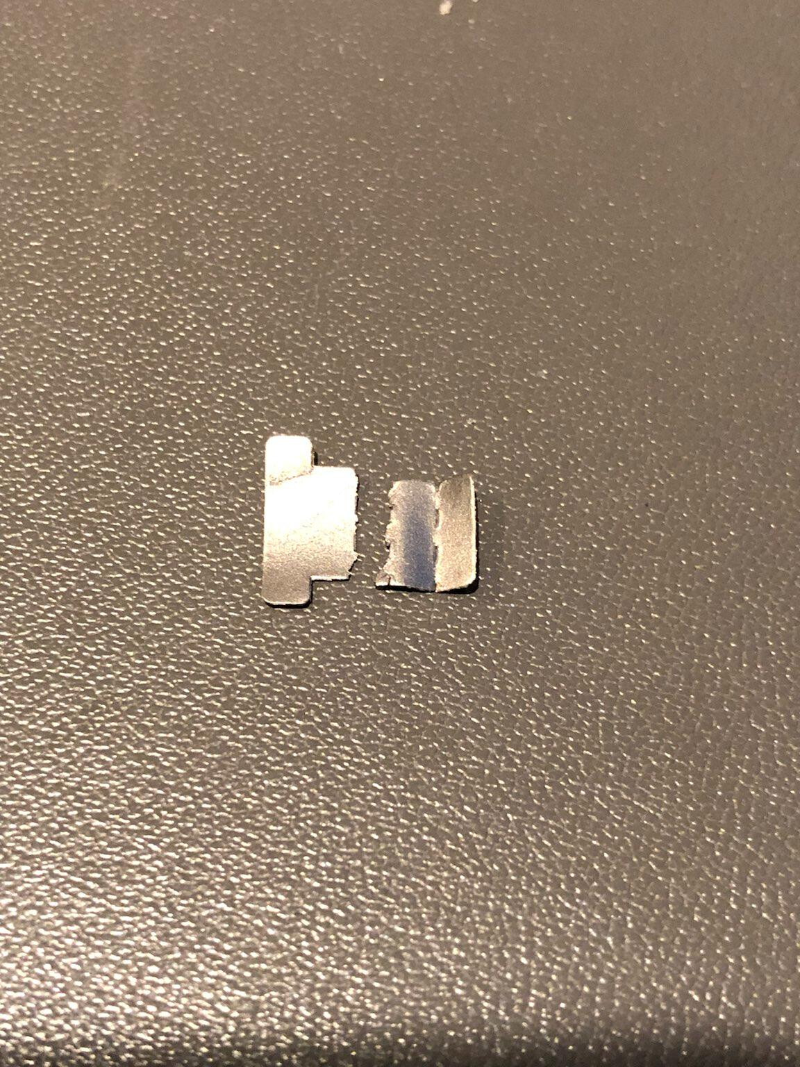

@nrp It is reaching 95°C. I looked at the An Expansion Card bay on my laptop does not function correctly (frame.work) guide and opened up the machine. 3 of the 4 seem to have this problem:
The one that seems okay:
The incorrectly installed ones:
The big problem now is that when I tried to move/adjust the last sticker, it ripped in half:
What can I do with that? Should I try to fix the other ones that are wrong/not yet ripped?
Can it function without these?
Thanks
@Jordan We don’t suggest adjusting the EMI stickers unless the port has a functional problem such as expansion cards not recognized or not charging. You can continue to use your system without the sticker and there should not be any difference in performance. If you want to, you can just place some tape over the top of the sticker to hold it together and reapply it.
