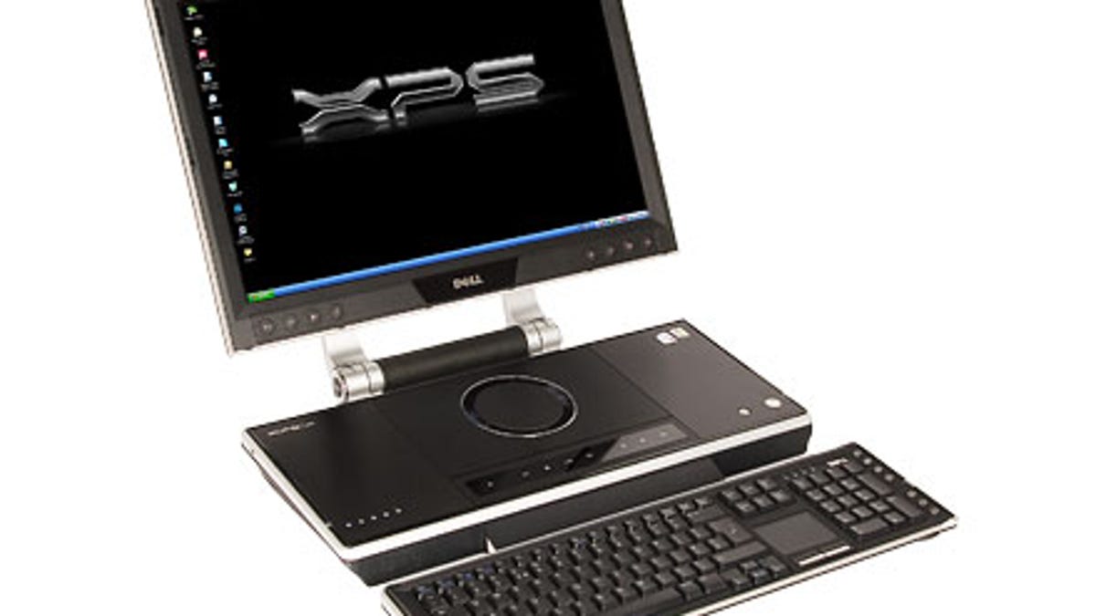

So in the early 2Ks I used to be a Dell repair technician. They had a monster that had a 20-in monitor attached to a laptop body. The thing was portable in the same way that 1990ās luggables were⦠And I just dated myself
. The thing was massive.
Good use of words because that thing is NOT, as a whole, a laptop. Holy cow! Audacious indeed, CNET.
