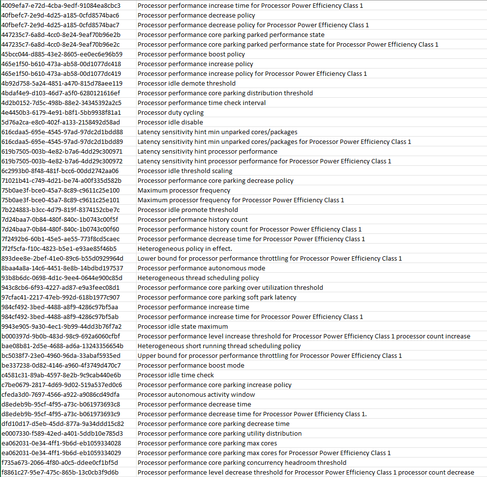

There is a relatively simple Powershell script that will generate a UI that will show you the registry key that points to a particular advanced option, but you will then have to take a trip into the registry editor to set the visibility on for the options you want, or write another Powershell script that modifies the registry for you.
To make an option visible, you’ll want to change the value to “2” - “1” means it’s not visible.
Here’s the Powershell command:
gci 'HKLM:\SYSTEM\CurrentControlSet\Control\Power\PowerSettings' -Recurse|? Property -contains 'Attributes'|gp|select Attributes, PSCHildName, @{ N = 'Name' ; E = { $_.FriendlyName.Split(',')[-1] }}|out-gridview
The registry key that needs to be modified is the second column in the grid.
