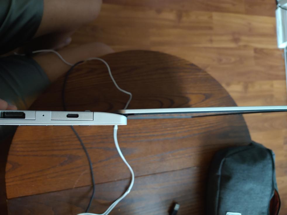

Would be interesting to know if it is physically possible with the laptop. Don’t have my hands on one right now, but has someone checked what’s stopping it from bending past 180 degrees?
Bottom edge of the top clamshell juts out a bit so that it bumps against the bottom clamshell at 180 degrees

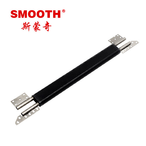

And at 13 inches, the hinge is in the form of a bar, so shouldn’t we implement it like the link?
