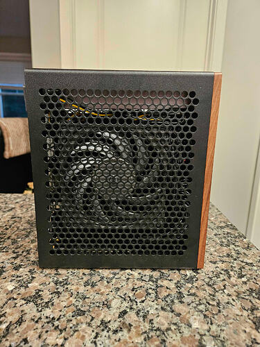

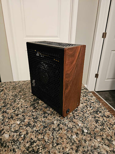

Other than that, it is just like any other motherboard. My only other issue was since I decided to design and 3d print my case I have to come up with the front buttons, and make that look good (hadn’t thought of that). Also keep an eye on airflow – the fan on top of the heat sink is meant to pull air from outside the case, so the fan shroud should fit in a case side opening (or top, depending on orientation) so that no inside-case-air gets sucked into the top of the heat sink, just good fresh outside-case air. With that, no other major cooling seems to be necessary.

Since I have a 3d printer and wanted a “fun” project, and had a full sized ATX power supply laying around I ended up doing a cubical case design (a bunch of flat panels that are connected together). Lower chamber holds the power supply, and has room for additional HDDs, and upper chamber holds the motherboard. It isn’t really that pretty of a design, but it is functional – will upload to printables.com (to join the many other designs out there) when I finish validating thermals, and make a couple of tweaks. The motherboard is mounted horizontally in the upper chamber, with a hole and grate for the fan intake, with a ring that extends down to mesh with the fan duct. Main thermals I’m worried about, is the heat sink fins are oriented front-to-back, so all air blows to the front and back directions – and in the front, there is one of the SSDs, so slightly concerned about keeping that cool (with hot CPU air blowing on top of it), plus if I have air vents in the front of the case that will be warm air blowing out the front right onto me. May look at doing some additional ducting, to direct air flow accordingly.
