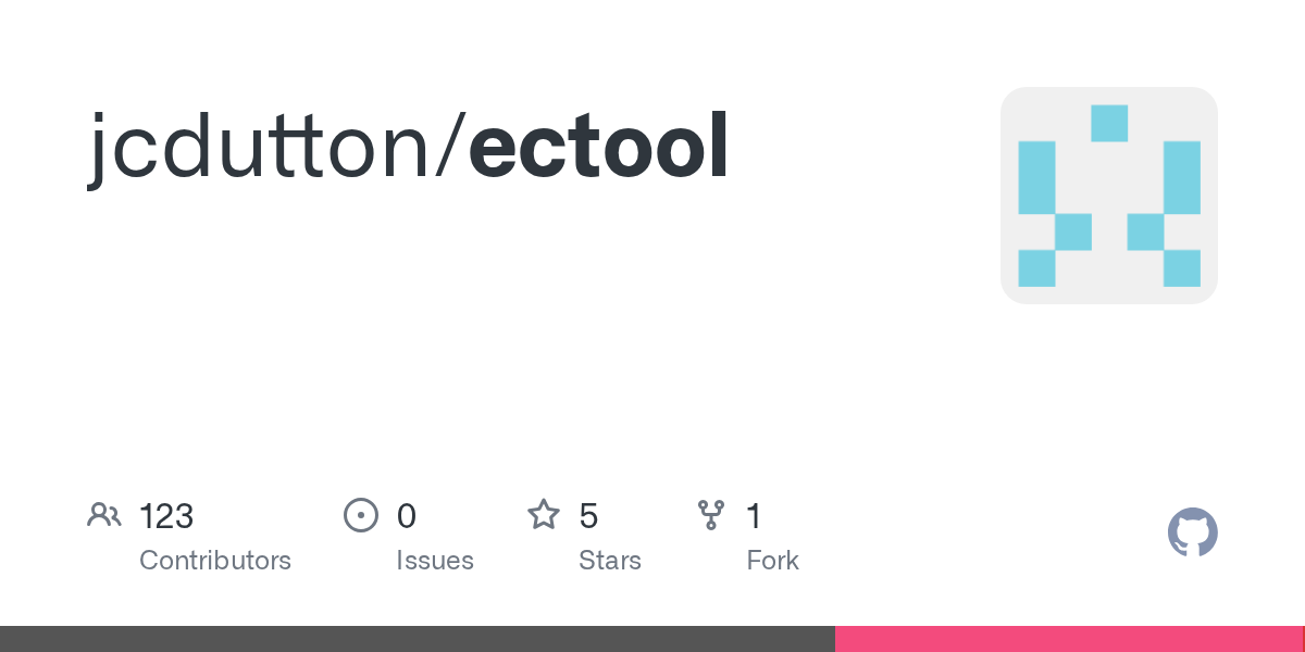

The LED should be controlled by the embedded controller which has a command to turn it off.
The details of sending commands to the embedded controller depend on your operating system.
Here are some commands you can use:
Turn light / LED off:
ectool led power off
Turn it back on / back to normal.
ectool led power auto
ectool can be run from Linux or Windows.
There is a version you can compile on my github here:
With a release version, pre-compiled for windows.
I did that and it’s better, thanks!
