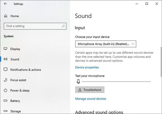

I have been unable to get any input from my laptop’s microphone. As far as I can tell, it is completely absent, and not just muffled. The only exception is when the privacy switch, which causes a short “blip” to register on the input channel. External USB microphones work just fine.

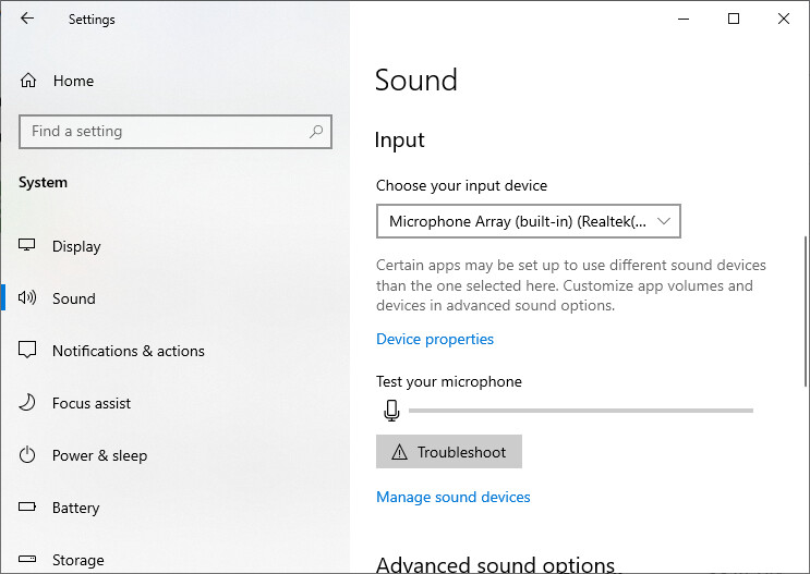

I had a video conference lately where the other party couldn’t hear me. In Windows sound settings, under “Test your microphone” (pictured below), when I speak and look at the mic audio level, it doesn’t register anything, until I get very close to it, like 1 foot away, and then just barely. As if the mic has some ginormous dynamic range (suspect). And this Windows settings behavior did not change after my attempted fix.
But since attempting the fix, I’ve tried other test methods (video recording myself with the camera app, and https://mictests.com/), and it seems to work fine. So now it’s not clear to me whether I ever had an actual problem other than whatever specific video conference software not picking up my mic, and the bad levels/UI/UX of the Windows Sound settings “Test your microphone” area.
