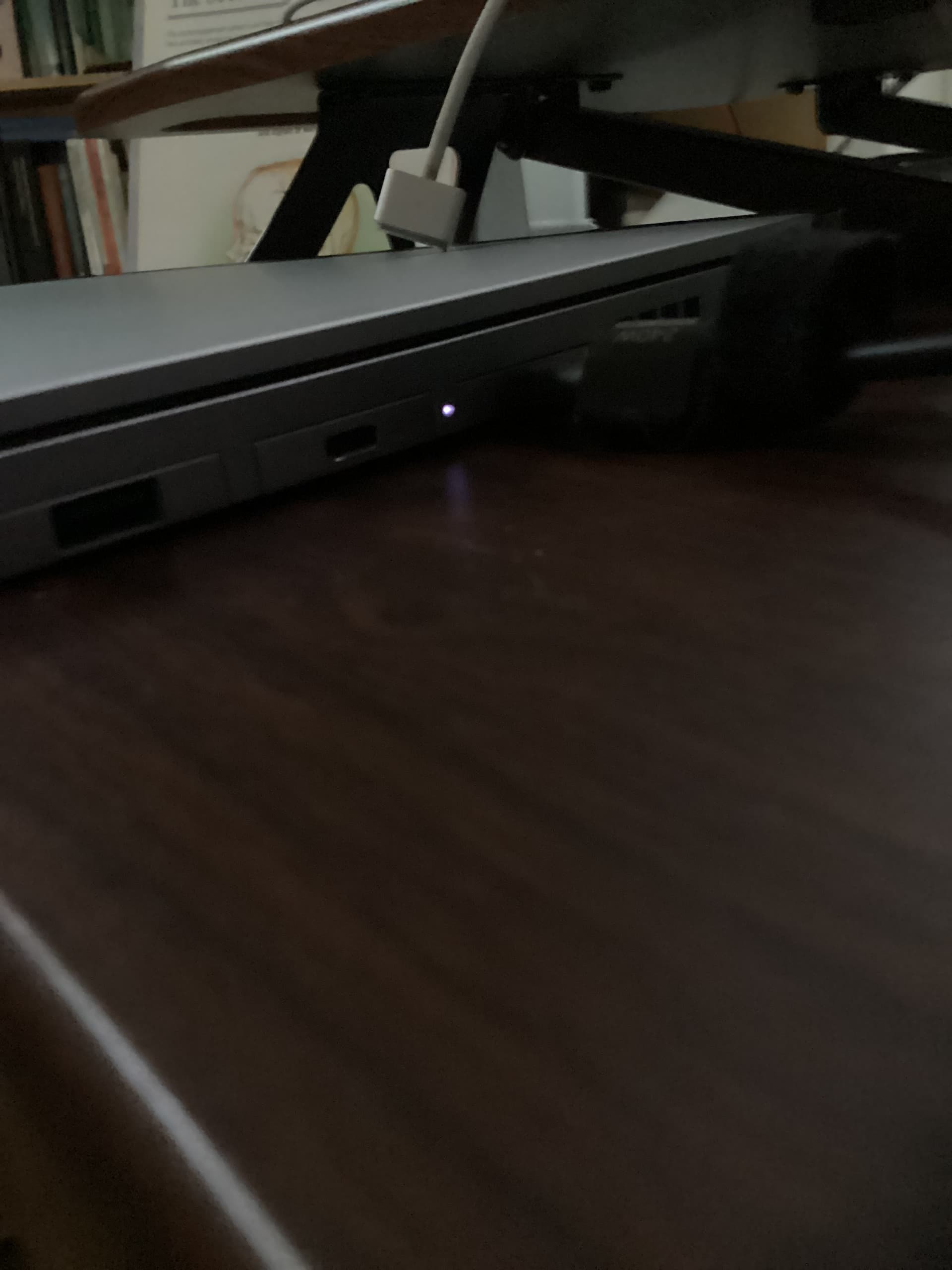

Framework 16 laptop is not turning on when I push the power button
The power button doesn’t even light up.
Something is alive in there.
I will note that I had problems with the eDP cord and the fingerprint reader cord when I was repairing the laptop.
