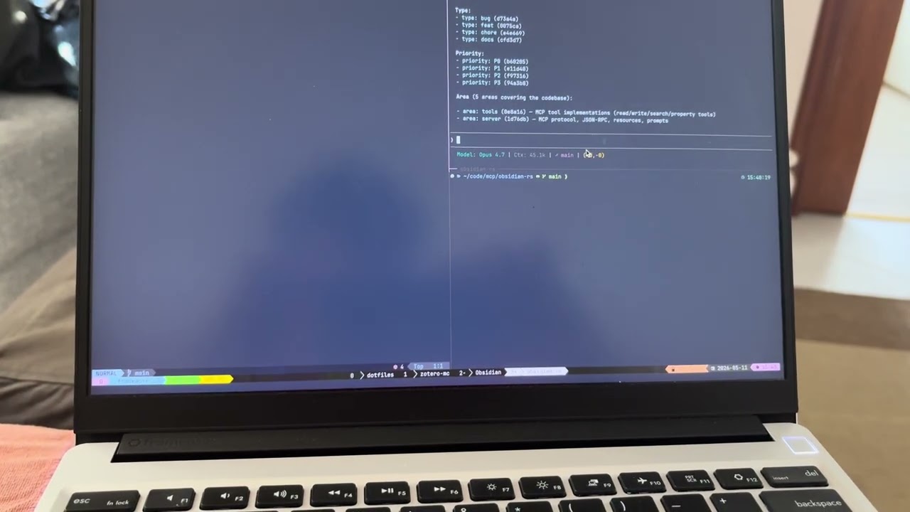

Please can you post a video of the flicker, and add a link to it.
Different types of flicker are due to many different things, so seeing what it looks like helps.
Based on your description.
The fact it works OK on external displays tends to rule out GPU software bugs.
The video shows an intermittent corruption of the image. It becomes offset in parts momentarily but much of the time the display displays accurately.
This would tend to mean the display panel itself is OK, leaving the problem being intermittent connection problems.

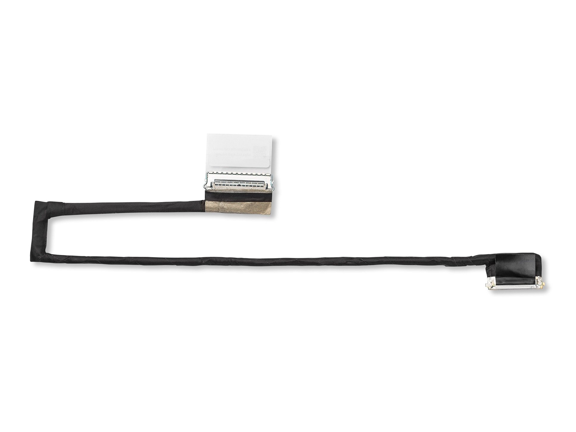

The cable between the mainboard and the display. This has a connector both ends of it, so it would be good to try removing and replacing the cable to ensure it is a good fit. It is a push fit, so can sometimes become a bit loose.
A intermittent hardware fault on the PCB, causing intermittent end-to-end connection problems. Either the small PCB on the display panel, or the mainboard PCB.
Of those two, I would suspect the cable as the most likely cause.
Remove and re-seat the cable both ends, and also look at the cable for any obvious damage.
The FW support/repair guides should help you identify how to get to the cable ends.
If you determine it is the display cable damage, you can get a replacement here:
