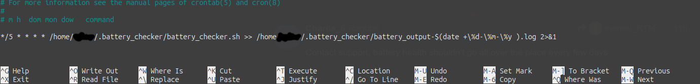

Thank you, I already have contacted support, but I haven’t had the battery jumping issue for some time. I actually have a cron job that does a bash script every 5 minutes, as pictured. Then, it will send the output in a log that is per day. First pic shows syntax in the cron config. Yes, you can create files with a cron job’s output file and have each day’s file be different. Haven’t got it separated for per month/year (as in the files they reside in), but I think it’s ok.
